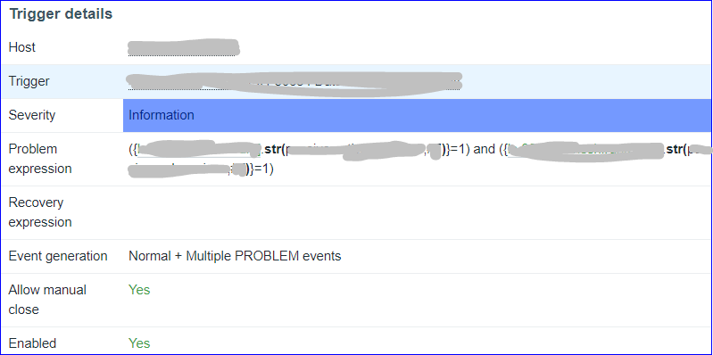

      it seems to be actually due to Zabbix "problem" generation, because even without activated mail actions the problems still appear twice on the dashboard with different problem IDs. Although the trigger is created on two different items, these collect the information once a day per host, according to the Latest data.
      Even if I test the trigger in multiple mode on a single item, the double problem generation per host still exists. Only if I change the trigger mode to single, the problem is generated once per host. I noticed the expression "Normal + Multiple" in the trigger details. In the trigger configuration itself, only "multiple" is selected. Could that be the reason?

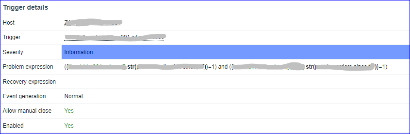

      • bix-u
        • Jun 2021
        Addendum: Here are the details of the same trigger where only the option "PROBLEM event generation mode" was changed to "single". The trigger no longer triggers a duplicate problem.
