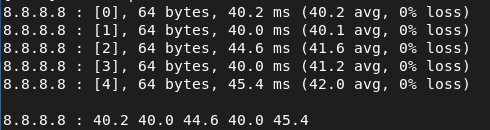

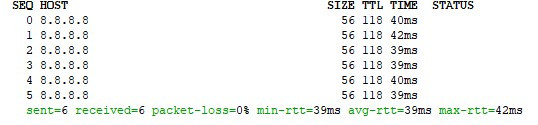

    Then I logged to my router and zabbix server to compare and it seems that even when the "zabbix simplecheck" is showing 160ms, a fping from console it showing 40ms and my router also confirm 40ms.

    Do you have any idea on what can cause this type of variation in zabbix?
