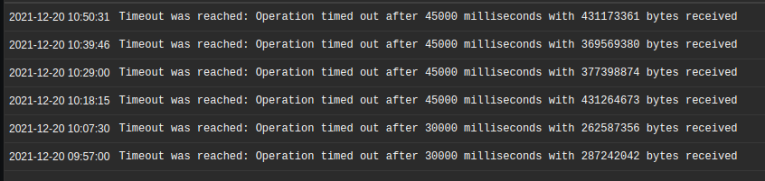

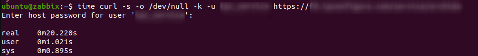

We require the monitoring of an API endpoint that can sometimes have a relatively large payload (500MB+) for performance reasons. When accessed with a curl command from the zabbix server it takes under 20-30 seconds to download. However, the web scenario step for the same endpoint consistently times out with a timeout setting as high as 45 seconds (see attached).

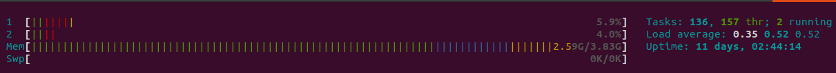

It does not appear to be a resource issue on the Zabbix server, using Zabbix 5.4.8 on Ubuntu 20.04 LTS:
