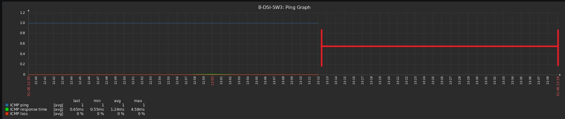

    All Host Graph display delayed, not current
    Please help me find a solution to this problem.
    All Host Graph display delayed & notification, not current
Name:	Screenshot 2022-01-06 134014.jpg
Name:	Screenshot 2022-01-06 133936.jpg

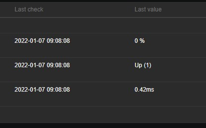

        Last check delay
Name:	Screenshot 2022-01-06 155038.jpg

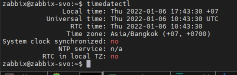

            • dimir
              Zabbix developer
              • Apr 2011
              • 1080
              But are they running ntp? If not:
              sudo apt install ntp
              • sirbank
                • Jan 2022
                • 20
                set time zone asia/bangkok
                Click image for larger version  Name:	Screenshot 2022-01-06 174415.jpg Views:	0 Size:	29.8 KB ID:	437785
                • dimir
                  Zabbix developer
                  • Apr 2011
                  • 1080
                  Do you see "System clock synchronized: no"? Please just run the command I gave you on both servers.

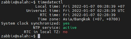

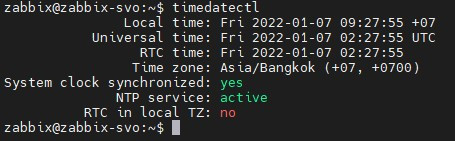

                  • sirbank
                    • Jan 2022
                    • 20
                    i setup is complete , but still encountering problems , Last check delay 30 min on current time
                    Zabbix Server
Name:	timedatectl server.jpg
                    Zabbix Proxy
