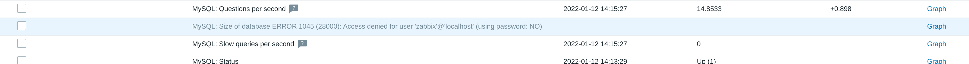

                        The only value that is not reported correctly is `MySQL: Size of database`:
                        template_db_mysql.conf shows:
                        UserParameter=mysql.dbsize[*], mysql -h"$1" -P"$2" -sN -e "SELECT COALESCE(SUM(DATA_LENGTH + INDEX_LENGTH),0) FROM INFORMATION_SCHEMA.TABLES WHERE TABLE_SCHEMA='$3'"
                        I verified I can do the SELECT statement when logged in on MySQL with the zbx_monitor user.
                        But for some reason it tries to use the zabbix user without a password?

                            Is it real database name "ERROR 1045..."?
                            Maybe you should drop this item... Configuration - Hosts - Discovery on your MySQL host - Database discovery - Keep lost resources period = 0d - Update. Then "Execute now" at this discover rule.

                              I changed the discovery and executed it, I now do see my real databases with the correct size values.
                              The error row is still there, but for me that's not a big issue.
