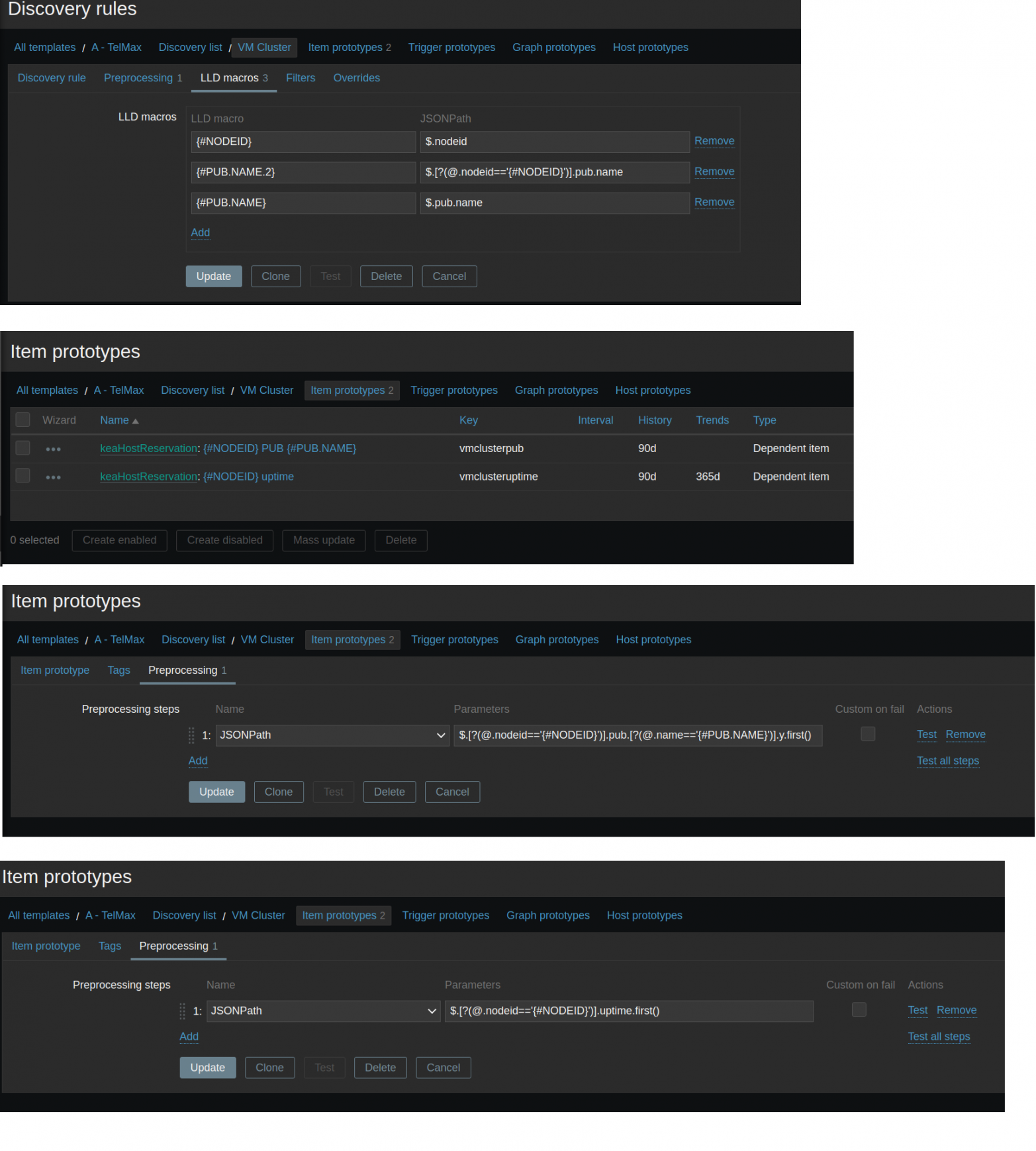

Configuration (image attached)
LLD macros on discovery rule:
Itemp-protype:
jsonstring:
LLD macro -> JSONPath
{#NODEID} -> $.nodeid
{#PUB.NAME.2} -> $.[?(@.nodeid=='{#NODEID}')].pub.name
{#PUB.NAME} -> $.pub.name
Name: {#NODEID} PUB {#PUB.NAME}
Preprocessing:
JSONPath -> $.[?(@.nodeid=='{#NODEID}')].pub.[?(@.name=='{#PUB.NAME}')].y.first()
