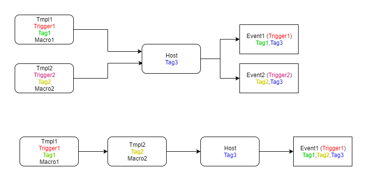

        • 4961
        yes you can see all tags from that "Monitoring -> host". That is according to docs
        Tags Tags of the host and all linked templates, with macros unresolved.
        But that does not mean, that all those tags apply to all events generated by that host. (From the page you linked: A problem event inherits all tags from the whole chain of templates, hosts, items, web scenarios, triggers).
        you have host with tags
        you have 2 templates attached to this host, each with their own tags.
        there are triggers in one template and none in other..
        Now... What happens... your trigger from that one template triggers and it inherits all tags from that chain: trigger (if they exists), then from that template, it is part of, and then from host... whatever there is in that other template, it will not inherit. It is not part of "chain".
        If you want to apply also tags from that other template, those templates should be linked... You can, for example, have a template with only macros and tags for specific host. Then you can link other template to this "macro template", which uses those macros and tags. When you attach first one to host, other template will be applied automatically. Anything from that intermediate template will be inherited..
        Trigger fires... Event inherits tags from trigger config, then from first template, then from second (linked) template, then from host...

          Hello @cyber
          I tested that now in Zabbix 5.0.11 and 5.0.19:
          On host vfw-1234 are these templates assigned
          TEMPLATE MAIN:
          TEMPLATE SYS1:
          ITEMS:
          - Item1
          - Item2
          TRIGGERS:
          - Trigger 1
          - Trigger 2
          TEMPLATE NQA:
          ITEM PROTOTYPE:
          - Item NQA TEST1
          - Item NQA TEST1
          TRIGGERS PROTOYPE:
          - Trigger NQA TEST1 (Includes TAG TRIGGER:NQA-PROBE-FAIL1)
          - Handovers SNMPINDEX to TAG SNMPINDEX:(#SNMPINDEX)
          - Handovers DEST IP to TAG NQADSTIP:(#NQADSTIP)
          - Handovers SRC IP to TAG NQASRCIP:(#NQASRCIP)
          - Trigger NQA TEST1 (Includes TAG TRIGGER:NQA-PROBE-FAIL2)
          TEMPLATE WITH TAGS ONLY (LINKED TEMPLATE TO TEMPLATE NQA):
          TAGS:
          - DC:DC1
          - DC-NAME:DCS1234
          The trigger is generating an event. In this event i can only see the Tags:
          - SNMPINDEX:(VALUE-OF-SNMPINDEX)
          - NQADSTIP:(Some IP Address)
          - NQASRCIP:(Some IP Address)
          But this Tags are still missing:
          - DC:DC1
          - DC-NAME:DCS1234
          Based on your picture, that should work:
          Template NQA which is linked to "TEMPLATE WITH TAGS ONLY" should also provide the Tags
          DC:DC1
          and
          DC-NAME:DCS1234
          if the Trigger Prototye Trigger NQA TEST1/2 is creating an event.
          Or am i still wrong?

              • 4961
              I assume from your description, that NQA template is attached to host and has "linked to tags template" in config? In this case trigger from NQA template will not inherit tags from "tags template" as it is further away from host in "chain"...
              Can you try other way around ... attach that "tags template" to host and then add that NQA template as linked to "tags template", in this case NQA template will be last in chain and trigger will "pass through" that "tags template" and inherit its contents.
