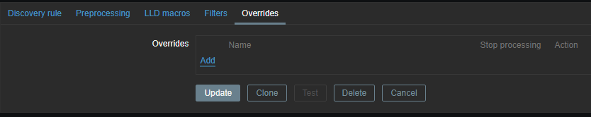

      No override section in the item
        • 4996
        Its not under "item prototype". It is separate tab under discovery itself... Hopefully you have at least version 5.0, where overrides appeared.

          Ok, i found the overrides, currently running v5.4.8, but it is not available, not a blue button to click, its just grayed out.
            • 4996
            I think you are trying to do it directly on host. You should do it in template.
