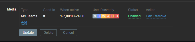

    Hey there,
    I'm currently trying to get a teams message from zabbix.
    I configured it and if I click "Test" in the mediatypes section it works just fine. I get a teams message.
    But if I now configure a trigger action with the user that has the msteams webhook attached to it, it does not work at all.
    I don't even get anything in the server log. No error, no ok. I also tried it with a log level of 4, but here also didn't show up any error or ok message.
    I tired sending it to the user and the group the user is in. Both times the same result. Nothing works.
    If you need further information please let me know.
    Here is my configuration:

    Thanks ahead for any help.
    Lukas

    cyber
    • 4972
    Does the user have access to the hosts, which generate those events? If not, then actions are not executed.
      • 4972
      • LukasN
        • Aug 2021
        That's it! Thank you so much.
        It's working now
