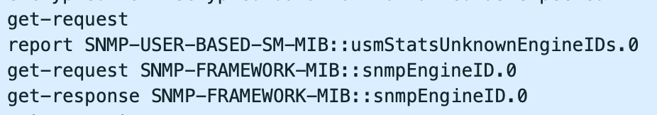

                  I have a capture, but it just shows the same thing over and over:Click image for larger version

                  Occasionally I see a packet going from Zabbix to the client that Wireshark is malformed, but because I can't see anything useful in them I can't tell you what they're doing.

                    Looking at one of my SNMPv3 Agent captures it goes as follows:
                    Message from Zabbix:
                    snmp.msgAuthoritativeEngineID: <MISSING>
                    snmp.msgAuthoritativeEngineBoots: 0
                    snmp.msgAuthoritativeEngineTime: 0
                    Encryption fields : empty
                    msgData: empty
                    Reply from monitored device:
                    snmp.msgAuthoritativeEngineID: <EngineID>
                    snmp.msgAuthoritativeEngineBoots: X
                    snmp.msgAuthoritativeEngineTime: Y
                    msgData: unencrypted varbind usmStatsUnknownEngineIDs
                    2nd Message from Zabbix:
                    snmp.msgAuthoritativeEngineID: <EngineID> (matches what was received previously)
                    snmp.msgAuthoritativeEngineBoots: X (matches what was received previously)
                    snmp.msgAuthoritativeEngineTime: Y (matches what was received previously)
                    Encryption fields : present
                    msgData: EncryptedPDU
                    2nd Reply from monitored device:
                    snmp.msgAuthoritativeEngineBoots: X (matches what was sent previously)
                    msgData: encrypteedPDU
                    Based on you saying that item changes from supported to not supported I'd expect that you should see some SNMP flows going like i described above, but some go in some different pattern. I'd be curious to see those that go differently.
                    P.S. you should be able to decrypt PDU of SNMP messages to see what is going in there if desired by supplying Wireshark with needed auth data in Edit -> Preference -> Protocols -> SNMP -> Edit User Table

                      Thanks. That helps explain a few things.
                      What I'm seeing is
                      msgUserName:
                      msgAuthenticationParameters: <MISSING>
                      msgPrivacyParameters: <MISSING>
                      msgData: plaintext (0)
                      plaintext
                      followed by
                      msgAuthoritativeEngineID: 8000a12f0452db1e6a34784df1acc61ce255ab0e42
                      msgAuthoritativeEngineBoots: 2
                      msgAuthoritativeEngineTime: 342532
                      msgUserName:
                      plaintext
                      then Zabbix transmits a packet that Wireshark can't make sense of. I think it's an attempt at authentication. I can see the username and some authentication/privacy parameters.
                      The error Wireshark throws when parsing that packet is
                      Expert Info (Warning/Malformed): BER Error: Sequence expected but class:UNIVERSAL(0) Constructed tag:335278 was unexpected
                      The host responds with a usmStatsWrongDigests packet
                      We then get a couple of rounds of useful packets - a blank get-request, a report response with the msg info in it, and then the actual OID being queried.
                      What's weird is that Zabbix then sends two authentication attempts, but with different msgAuthoritativeEngineTimes (significantly far apart). The remote host seems to ignore these.
                      I wonder if some rogue process within Zabbix has got stuck and keeps trying to authenticate on its own.
