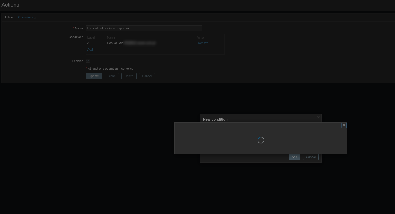

    Hi
    I'm trying to configure action for a certain trigger, but I am unable to choose it.
    I need 'Unavailable by ICMP ping' for a certain host.
    In the textbox 'type here to search', some results are being shown, but I need more so I choose "Select" and then it hangs, doing nothing, see attached screenshot.
    I've waited for like 20 minutes. There is nothing out of the ordinary in logs, everything else is working as it should.

      I managed to fix it.
      Had to edit not only php.ini, but also
      /etc/zabbix/apache.conf
      Increased those 3 values
      php_value memory_limit 256M
      php_value post_max_size 56M
      php_value upload_max_filesize 56M
      Anyhow, here's logs I gathered so maybe this will help someone
      console in browser
      jsLoader.php?ver=6.0.0&lang=en_US&showGuiMessaging =1:10111 POST https://zabbix.mydomain.com/zabbix.php?sid=03162485654994f1&action=popup.gener ic 500 (Internal Server Error)
      send @ jsLoader.php?ver=6.0.0&lang=en_US&showGuiMessaging =1:10111
      ajax @ jsLoader.php?ver=6.0.0&lang=en_US&showGuiMessaging =1:9692
      Overlay.load @ jsLoader.php?ver=6.0.0&lang=en_US&showGuiMessaging =1:20578
      PopUp @ jsLoader.php?ver=6.0.0&lang=en_US&showGuiMessaging =1:18199
      (anonymous) @ jsLoader.php?ver=6.0.0&lang=en_US&showGuiMessaging =1:28273
      dispatch @ jsLoader.php?ver=6.0.0&lang=en_US&showGuiMessaging =1:5432
      elemData.handle @ jsLoader.php?ver=6.0.0&lang=en_US&showGuiMessaging =1:5236
      /var/log/apache2/error.log
      [Fri Feb 18 18:55:33.623015 2022] [php7:error] [pid 38148] [client 192.168.xx:53044] PHP Fatal error: Allowed memory size of 134217728 bytes exhausted (tried to allocate 20480 bytes) in /usr/share/zabbix/include/classes/debug/CProfiler.php on line 195, referer: https://zabbix.mydomain.com/actionconf.php?eventsource=0&form=update&actionid= 11
      [Fri Feb 18 18:55:33.623621 2022] [php7:error] [pid 38148] [client 192.168.xx:53044] PHP Fatal error: Allowed memory size of 134217728 bytes exhausted (tried to allocate 20480 bytes) in /usr/share/zabbix/include/classes/debug/CProfiler.php on line 259, referer: https://zabbix.mydomain.com/actionconf.php?eventsource=0&form=update&actionid= 11
      [Fri Feb 18 18:55:33.623906 2022] [php7:error] [pid 38148] [client 192.168.xx:53044] PHP Fatal error: Allowed memory size of 134217728 bytes exhausted (tried to allocate 20480 bytes) in /usr/share/zabbix/include/classes/core/CEncryptedCookieSession.php on line 66, referer: https://zabbix.mydomain.com/actionconf.php?eventsource=0&form=update&actionid= 11
      [Fri Feb 18 18:55:33.624097 2022] [php7:error] [pid 38148] [client 192.168.xx:53044] PHP Fatal error: Allowed memory size of 134217728 bytes exhausted (tried to allocate 20480 bytes) in /usr/share/zabbix/include/classes/debug/CProfiler.php on line 345, referer: https://zabbix.mydomain.com/actionconf.php?eventsource=0&form=update&actionid= 11
