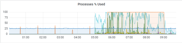

    I have a performance issue with Zabbix.
    Every 4 weeks/28 days, the history syncer internal proccesses go up to +80% for a few hours, and during this period, when housekeeping happens, it also goes to 100%, see graph below. Light blue is history syncer processes, orange is housekeeping.
    You can see housekeeping being executed every hour, but normally it only runs for a minute.
    During the high load, Zabbix performance is very bad, and a lot of triggers fire due to slow response of the checks.
    I'm not sure what causes this.

    You don't say what version of Zabbix server you're using. It's often useful to provide that info when you're asking questions on the forums. If you're using a long-term support (LTS) release, like 5.0 LTS, making sure you're running the latest minor version in that series is often a good place to start. There are query performance improvements sometimes even late into the lifetime of an LTS.
    For a small environment, your Zabbix settings seem too big. I would try reducing your ZBX_STARTTRAPPERS and your ZBX_STARTDBSYNCERS to half of your current value, and I would also reduce ZBX_STARTPOLLERSUNREACHABLE to 1/10th of your current value. With 31 hosts you're monitoring, I can pretty much guarantee that you don't need 50 unreachable pollers. I'm not sure what to say about your various cachesize settings, but I suspect they may also be contributing to your issue. If it were my environment, I would probably try reducing all of the XXXCacheSize settings to half their current values (or maybe 1/4 for the two History-related cache settings) and see if that improves things.
    I know it seems counterintuitive that performance could increase if you dedicate less memory for caching and run fewer "worker" processes, but it's definitely possible it will.

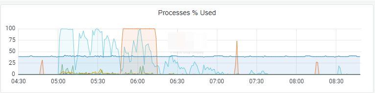

          A small update on the issue, your advised changes helped a lot!
          The issue isn't completely gone yet, but as you can see, the 100% process use time was much shorter, and we didn't get flooded with alerts anymore.
          We'll go on and tweak the parameters some more and eventually try to reach an optimal solution.
          I also doubled the size of the mysql InnoDB buffer pool from 125mb (default value from mysql docker image) to 250mb. As we have more than enough memory on the server, this can be further increased if necessary.

            Excellent! I'm glad things improved a bunch, and you have future room to tinker and improve things further.
            The InnoDB buffer pool change you made is a good one too. As I'm sure you saw in the MySQL or MariaDB docs, increasing the buffer pool is one of the single biggest performance "wins" you can get on a MariaDB/MySQL database using InnoDB/XtraDB tables. Because you've got a system that's shared not just with Zabbix server but also with other tools, you probably can't give InnoDB a huge chunk of memory, but that's one of the few database settings I tune even when there aren't any problems on a system.
