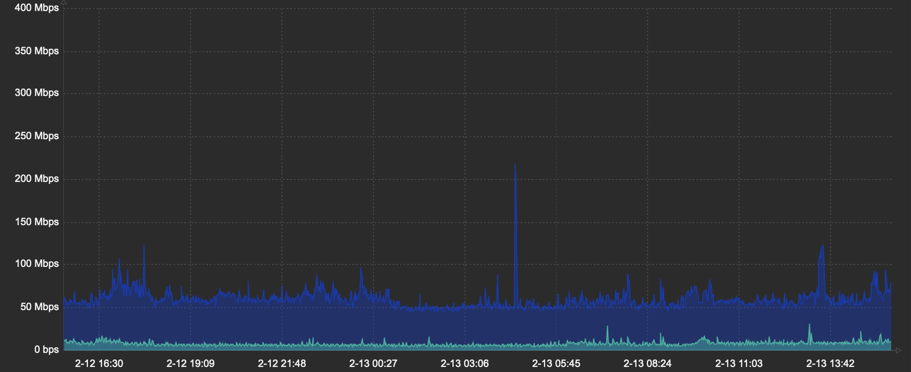

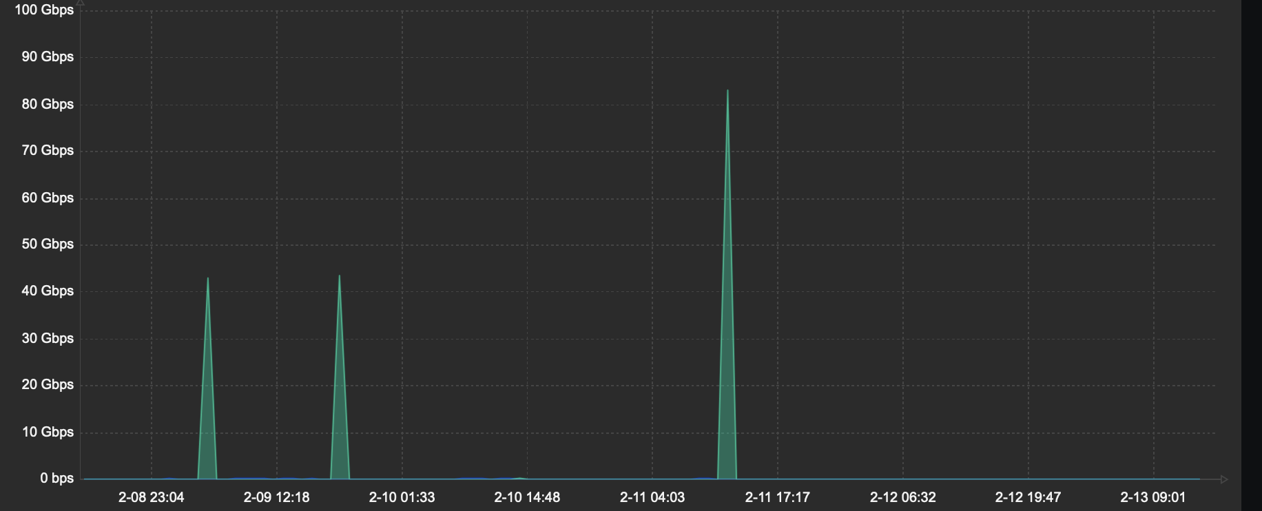

    Hi all. We are about at the end of how far we can take this, so asking the forum for some help.
    We have an instance updated to 5.4.8, and we monitor a range of devices mostly Cisco and Juniper, however we have a random High Bandwidth alert issue. The raw data from the devices has been checked and the bandwdith is definitely stable, it does ramp up and down but not to these reported levels. This seems to impact both Cisco and Juniper default templates, and we are monitoring on 1m intervals.
    This example is a 20G port channel (2 x 10G ports) sometimes showing traffic bursting to 100G, which is impossible! During these periods we are seeing traffic increasing to maybe 8-9G from the raw data.
    This seems to impact physcal ports as well as LAG's.
    We've seen some people talking about changing pre-processing orders which we've changed about with no luck. We've also changed from 32-64 bit counters and back and forth a few times, still no change. This is utilising the default Cisco and Juniper templates, apart from changing the monitoring interval.
    Any help greatly appreciated!

    Hi all. Just to update further. We have upgraded the whole estate to 6.0 LTS. Problem persists.

                tikkami i think this might be what it is, or at least something along these lines. Traffic is bursty (if that's a word) on this port. It will go from 200Mb to 10Gb in a few seconds. I wonder if Zabbix is mis-calculating that burst and forecasting or projecting the data? I now know of at least 3 other people having the same issues, all with the same symptoms. Interestingly though, at this moment this 'seems' limited to Juniper devices, it's not impacting Cisco devices in the same way as of yet. Any thoughts on how to solve this?

                    Collected some data today from Cisco switch.
                    Item OID: IF-MIB::ifOutUcastPkts.
                    This item has only change per second preprocessing.
                    Maybe next step is to add items to collect raw data to Zabbix...

                      I've been doing a bit of digging into patterns around this. Currently looking as to why the resolution message for this issue is sent 15 mins later than the event actually 'clearing' in Zabbix. I think we know why this is, but we've had another sequence of events this evening causing more of the same high bandwidth alerts. This time though traffic on this Juniper switch was stable throughout and wasn't ramping up.
