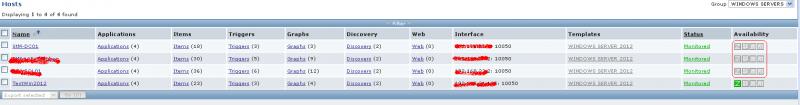

    The issue is that for some reason when I go to "Configuration" -> "Hosts" on zabbix frontend, those newly added hosts are shown with gray "Z" icon. I've waited a day and checked again - but the result is the same "Z" is still gray.
    How can I proceed with troubleshooting this issue?

      There are several items already (from a template assigned to those hosts), but still icon is gray. I have another MS servers with installed agent with green "Z" icon.

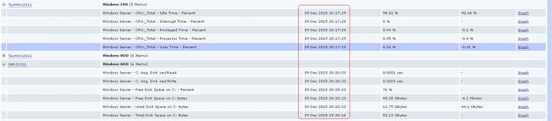

            Yes, there are values received from Zabbix server (screenshot provided). I can't see anything related to those hosts in zabbix_server.log

                    That's it! I didn't have any passive checks, only active ones. I've just changed an item to be "Zabbix agent" and now I can see the "Z" green
