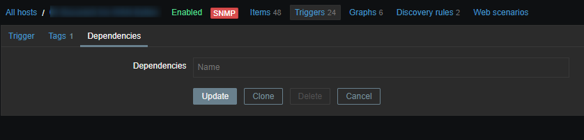

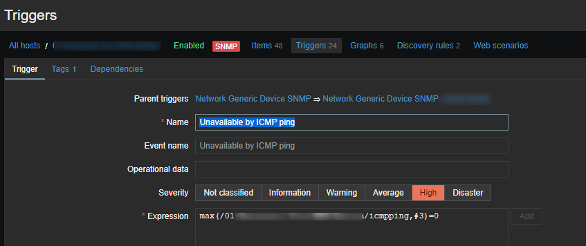

    How can I configure the dependency between hosts in version 6.0.0 LTS?
    I have the situation
    Zabbix - Router1 - Router2 - Host
    in the official documentation (3 Trigger dependencies (zabbix.com)) I find that I can do "Trigger dependency may be added from any host trigger to any other host trigger, as long as it wouldn't result in a circular dependency."
    Can't find the add button

  • gzdzie
    • Feb 2022
    Have the same problem - dependencies can be created only for template triggers. Inherited triggers doesn't have Add button. Cant find this on bug tracker.
