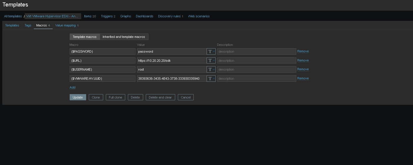

                    I am using Virt VMware Hypervisor ESXi - Andre Bello after import template in the zabbix I did follow steps:
                    1- added 3 macro
                    {$USERNAME} ----> root
                    {$PASSWORD} -----> password
                    {$URL} -----> https://esxi1.com/sdk
                    but cannot discovery and show :
                    Unknown hypervisor uuid.
                    How can I solve this problem?

                        • bab
                          • Aug 2020
                          • 183
                          I did all steps also defined new macro for UUID but it still show same error " Unknown hypervisor uuid."
                          What is the issue ?

                              But As I am using this template :
                              if you open the template . there is not any value such as VMWARE.HV.UUID
                              • StefTresMan
                                • Feb 2022
                                • 32
                                #15
                                Ah, I see now. Well, this post is about a totally different template, so i advise you to start a new thread for your specific problem.
