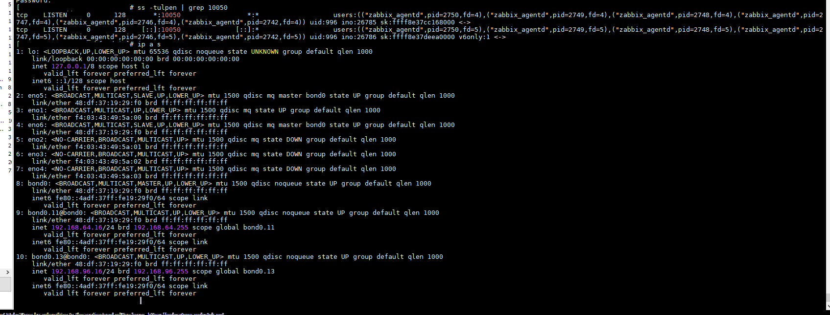

      Hey V-Test,
      I assume you are running zabbix on a linux system. Could you please provide the output of
      ss -tulpen | grep 10050
      and
      ip a s
      The Zabbix server ip-address is configured in /etc/zabbix/zabbix-server.conf and like tikkami already said, you should always be able to get data from the zabbix-server via localhost (127.0.0.1).

        This is my output from those commands. I'm not sure what is meant by changing the IP at Linux?

          Your linux has 3 IP-addresses.
          • 127.0.0.1, localhost address, Zabbix uses this address internally between server, database, frontend and local agent.
          • 192.168.64.16, bond0.11, address for external communication
          • 192.168.96.16, bond0.13, address for external communication
          Which address you were about to change? By default Zabbix server listens all above addresses.
          Changing external addresses does not affect to internal communication. There is no need to touch Zabbix configuration when external addresses are changed.
