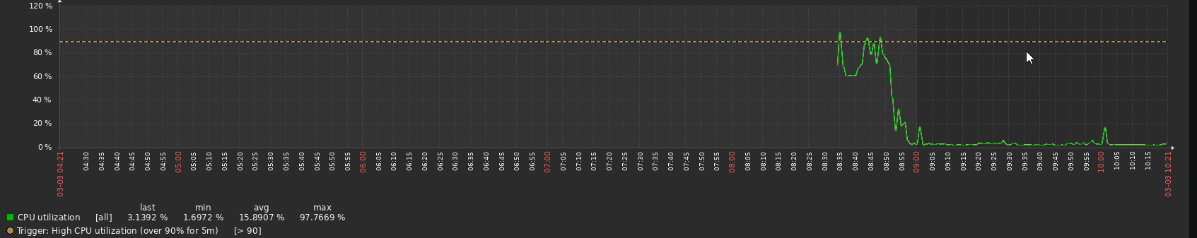

    I upgraded my environment from 6.0.0 to 6.0.1 and have this message : Utilization of configuration syncer processes over 75%. Before the upgrade was CPU utilization 0,6% and now is 34%. Im using 3 Proxys.
    Nothing bad in the logs on all servers.

        Zabbix server do not collect any data. This query killed my Zabbix.

          Solution : I killed this query in DB and we are back on track ;-)
          mysql -uroot -pzabbix -e "show processlist"
          mysql -uroot -pzabbix -e "kill 450" In my case the slow query ID was 450. It was just "select" query, so the DB do not crash.
          Click image for larger version  Name:	cpu2.png Views:	0 Size:	36.0 KB ID:	440807
