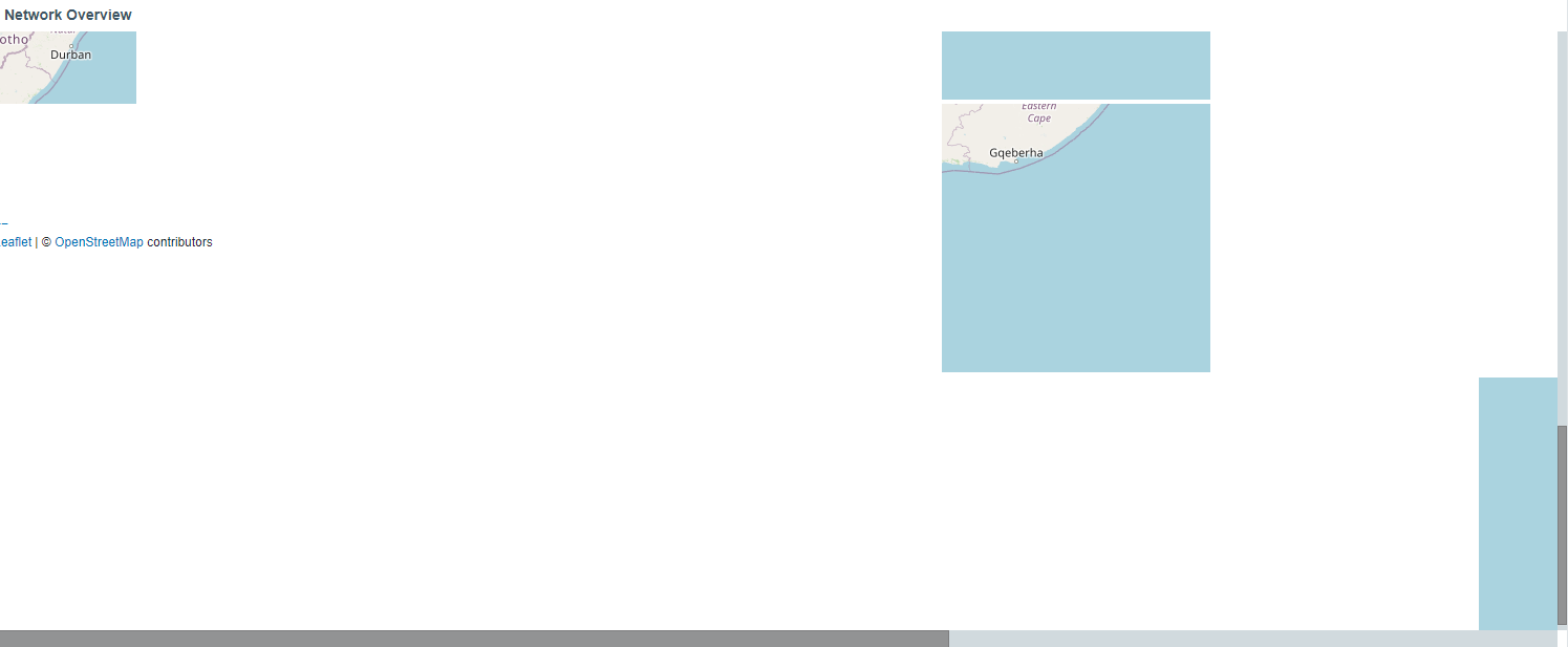

    On version 6.0 LTS. When I add a new Geomap widget and two hosts with latitude and longitude filled out, I just get a bunch of random map tiles and the + and - are just tiny little hyperinks.
    If I zoom in and out with the scroll wheel the tiles just jump around randomly.
    Only thing I can think is because I'm using Nginx instead of Apache, but I have not seen any issues with viewing anything else.
    Here's a picture:
Name:	geomap widget.png

    I am having the exact same issue with any tile provider. I am using Zabbix 6.0.3 and nginx as frontend ssl proxy
    Appreciate if someone can assist.

        I tried with multiple browsers but same result. My Internet is stable and have no other rendering issues

          I have the same situation, tell me no one found a solution?

            Finally I found a solution, which is described in https://www.zabbix.com/documentation...n/known_issues
            Geomap widget error
            The maps in the Geomap widget may not load correctly, if you have upgraded from an older Zabbix version with NGINX and didn't switch to the new NGINX configuration file during the upgrade.
            To fix the issue, you can discard the old configuration file, use the configuration file from 6.0 package and reconfigure it as described in the download instructions in section e. Configure PHP for Zabbix frontend.
            Alternatively, you can manually edit an existing NGINX configuration file (typically, /etc/zabbix/nginx.conf). To do so, open the file and locate the following block:
            location ~ /(api\/|conf[^\.]|include|locale|vendor) {
            deny all;
            return 404;
            Then, replace this block with:
            location ~ /(api\/|conf[^\.]|include|locale) {
            deny all;
            return 404;
            location /vendor {
            deny all;
            return 404;

              Works like a charm. Thanks

              Thanks mate! This helps a lot and fixed my problem as well!
