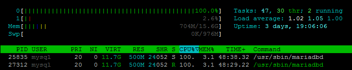

    After starting Zabbix Server the CPU load goes up to 100% (on one core) and stays there. Checking htop I can see that MariaDB is causing the load spike:

    This process keeps running seemingly forever or until I manually kill it. I've had it running over night in case it might just be a case of me being impatient but finally ended up killing the process in the morning (killing the process within MariaDB not MariaDB itself). After that the CPU load was back to near 0%. Since this is a brand new installation there's not much data (other than what comes with the default sql statements during installation) that would need to be processed either. I've also checked the output of MariaDB error log which is clean apart from normal startup messages. I've also checked journlactl for service startup problems but again nothing except normal startup messages.

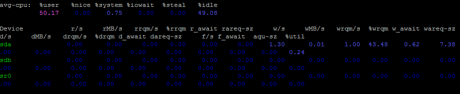

    ​Hey little_martian,
    Thanks for taking the time to reply. I've changed the MariaDB configuration in a way that it allows the use of max. 12GB RAM (Zabbix is the only db and I'll fine tune actual requirements later). Below is the output of "iowait -mxy 10' (average over 10 seconds interval).

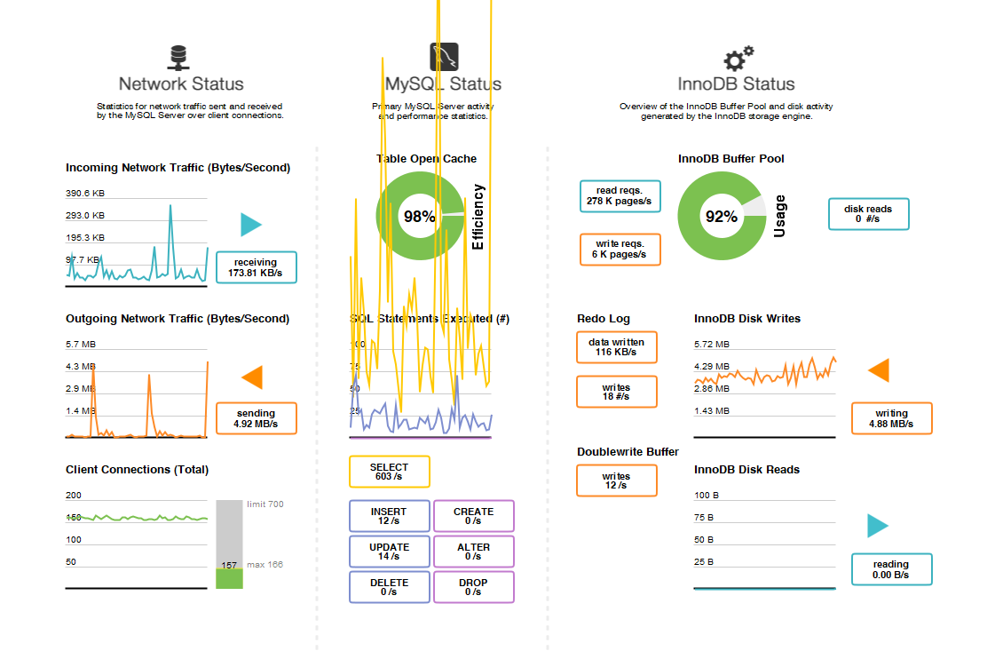

      Check also with MySQL Workbench, Administration tab, Performance->Dashboard. Below is from my old installation, similar configuration as above.
