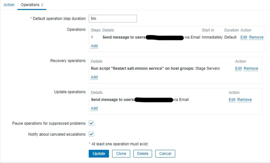

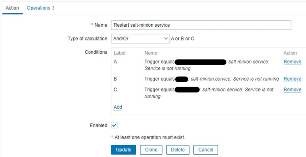

              Then I created Trigger actions under Configuration-> Actions -> trigger actions
              then the operations
