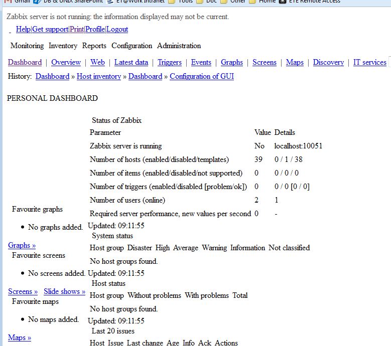

            I have attached a screenshot of what I am seeing. It looks like the PHP code is being loaded and interpreted fine. I validated that the php module is getting loaded by apache and that the .php files are being read correctly.

              Same here. php info page displays correctly. php modules are loaded by apache but still [page shows as text.
