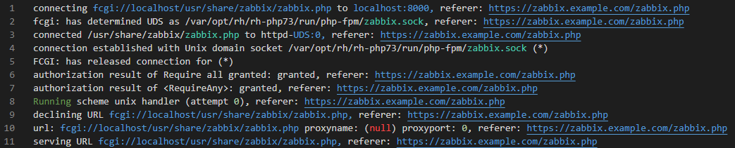

        Those logs would be in the web server access and error logs
        I checked those with httpd debug enabled. access_log just gives events with 200 code and error_log shows that connection is established with zabbix.sock on php-fpm directory.
        connecting fcgi://localhost/usr/share/zabbix/zabbix.php to localhost:8000, referer: https://zabbix.example.com/zabbix.php
        fcgi: has determined UDS as /var/opt/rh/rh-php73/run/php-fpm/zabbix.sock, referer: https://zabbix.example.com/zabbix.php
        connected /usr/share/zabbix/zabbix.php to httpd-UDS:0, referer: https://zabbix.example.com/zabbix.php
        connection established with Unix domain socket /var/opt/rh/rh-php73/run/php-fpm/zabbix.sock (*)
        FCGI: has released connection for (*)
        authorization result of Require all granted: granted, referer: https://zabbix.example.com/zabbix.php
        authorization result of <RequireAny>: granted, referer: https://zabbix.example.com/zabbix.php
        Running scheme unix handler (attempt 0), referer: https://zabbix.example.com/zabbix.php
        declining URL fcgi://localhost/usr/share/zabbix/zabbix.php, referer: https://zabbix.example.com/zabbix.php
        url: fcgi://localhost/usr/share/zabbix/zabbix.php proxyname: (null) proxyport: 0, referer: https://zabbix.example.com/zabbix.php
        serving URL fcgi://localhost/usr/share/zabbix/zabbix.php, referer: https://zabbix.example.com/zabbix.php
