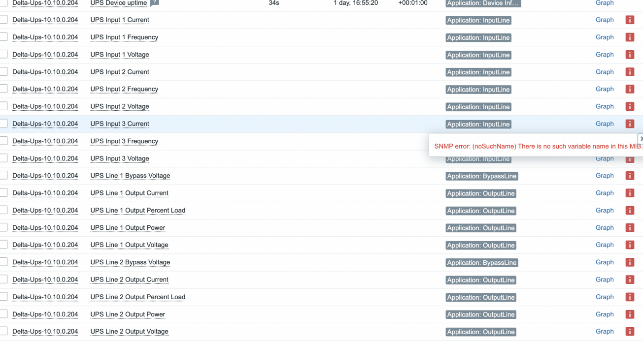

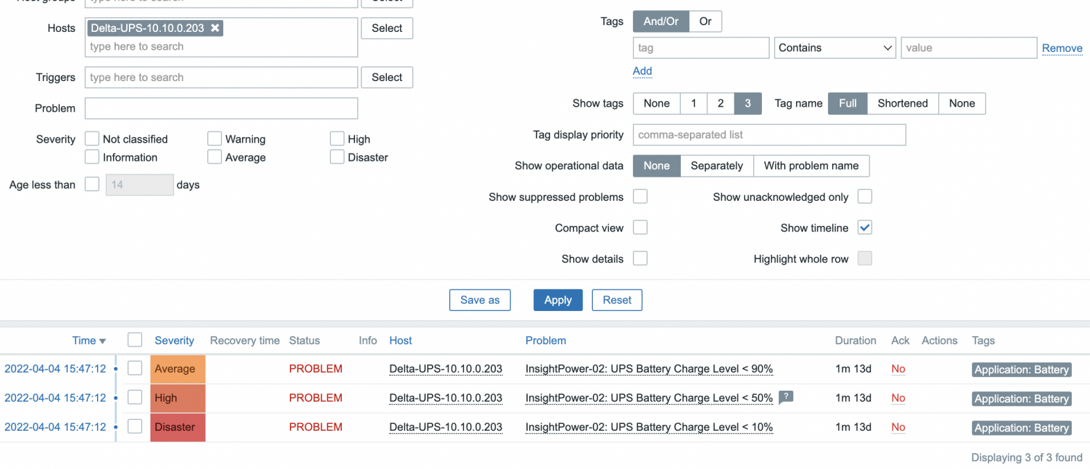

    Hello Everyone,
    Last night my building I'm working on was cut power. But Zabbix doesn't send alerts to my slack channel & email ( but I still receive other notification errors to my channel & email ).
    + I'm using a template here
    + My config as below,
    Thanks & Regards.

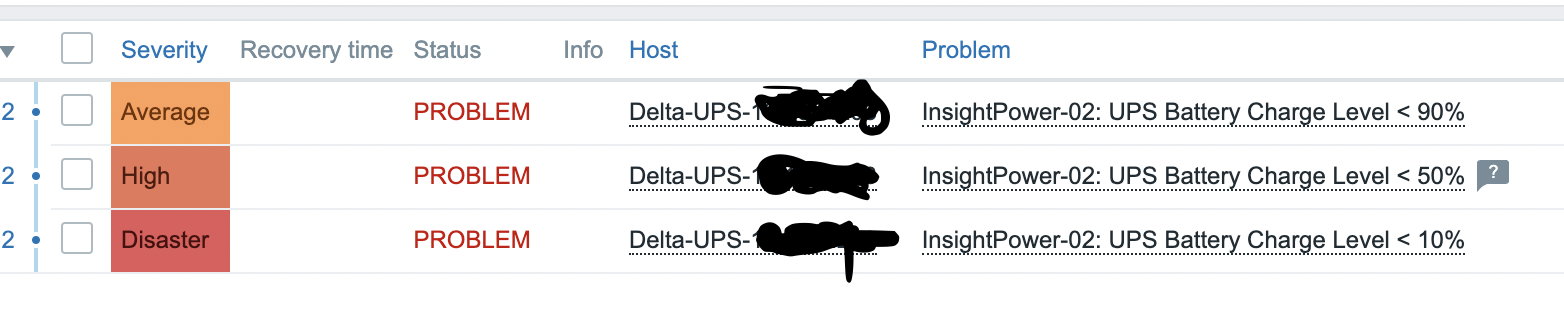

      Hello Cyber,
      Just notification ICMP ping alert to Slack Channel & problem with UPS Battery Charge Level.
      Thanks & Regards.
