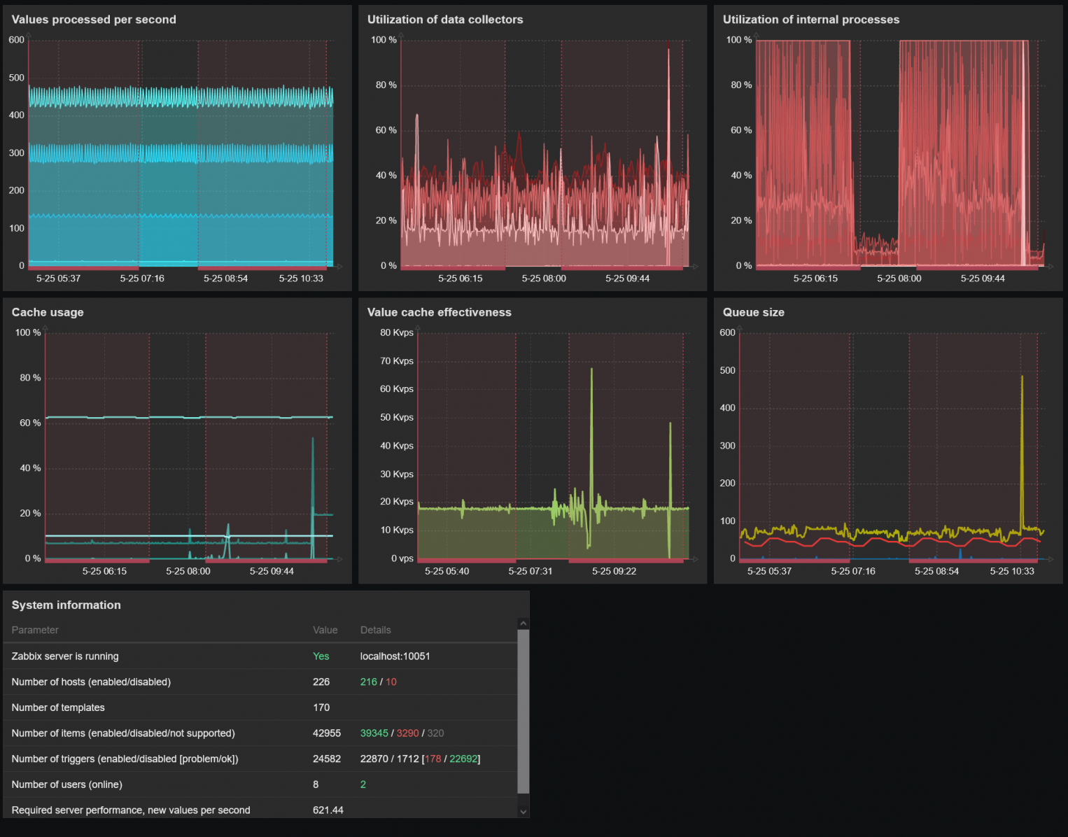

          One more question: when your housekeeper runs for 2.5 hours and then completes, how many records is it typically removing during a run? This info is probably being logged to your zabbix_server.log file every time the housekeeper runs. I'm curious how much cleanup it's actually doing in the 2.5 hours you've indicated it takes to run.
          Is this what you are looking for:
          sudo cat /var/log/zabbix/zabbix_server.log | grep housekeeper
          3219:20220523:072350.047 housekeeper [deleted 6021402 hist/trends, 45000 items/triggers, 8 events, 8 problems, 0 sessions, 0 alarms, 0 audit, 0 records in 16454.559009 sec, idle for 1 hour(s)]
          3219:20220523:082350.546 executing housekeeper
          3219:20220523:113601.179 housekeeper [deleted 6022323 hist/trends, 45000 items/triggers, 4 events, 20 problems, 0 sessions, 0 alarms, 0 audit, 0 records in 11530.631564 sec, idle for 1 hour(s)]
          3219:20220523:123601.663 executing housekeeper
          3219:20220523:154941.418 housekeeper [deleted 6021837 hist/trends, 45000 items/triggers, 4 events, 6 problems, 0 sessions, 0 alarms, 0 audit, 0 records in 11619.753409 sec, idle for 1 hour(s)]
          3219:20220523:164941.928 executing housekeeper
          3219:20220523:200501.533 housekeeper [deleted 6030450 hist/trends, 45000 items/triggers, 14 events, 7 problems, 0 sessions, 0 alarms, 0 audit, 0 records in 11719.603501 sec, idle for 1 hour(s)]
          3219:20220523:210502.020 executing housekeeper
          3219:20220524:002009.273 housekeeper [deleted 6053992 hist/trends, 45000 items/triggers, 5 events, 9 problems, 0 sessions, 0 alarms, 0 audit, 0 records in 11707.250980 sec, idle for 1 hour(s)]
          3219:20220524:012009.739 executing housekeeper
          3219:20220524:043352.251 housekeeper [deleted 6088391 hist/trends, 45000 items/triggers, 6 events, 18 problems, 0 sessions, 0 alarms, 0 audit, 0 records in 11622.510095 sec, idle for 1 hour(s)]
          3219:20220524:053352.737 executing housekeeper
          3219:20220524:093132.895 housekeeper [deleted 5929487 hist/trends, 45000 items/triggers, 0 events, 9 problems, 0 sessions, 0 alarms, 0 audit, 0 records in 14260.156059 sec, idle for 1 hour(s)]
          3219:20220524:103133.398 executing housekeeper
          3219:20220524:134450.960 housekeeper [deleted 6066631 hist/trends, 45000 items/triggers, 4 events, 15 problems, 0 sessions, 0 alarms, 0 audit, 0 records in 11597.559680 sec, idle for 1 hour(s)]
          3219:20220524:144451.439 executing housekeeper
          3219:20220524:175708.444 housekeeper [deleted 6068470 hist/trends, 45000 items/triggers, 9 events, 7 problems, 0 sessions, 0 alarms, 0 audit, 0 records in 11537.003650 sec, idle for 1 hour(s)]
          3219:20220524:185708.921 executing housekeeper
          3219:20220524:221456.657 housekeeper [deleted 6068614 hist/trends, 45000 items/triggers, 3 events, 6 problems, 0 sessions, 0 alarms, 0 audit, 0 records in 11867.734889 sec, idle for 1 hour(s)]
          3219:20220524:231457.136 executing housekeeper
          3219:20220525:023149.439 housekeeper [deleted 6075824 hist/trends, 45000 items/triggers, 4 events, 6 problems, 0 sessions, 0 alarms, 0 audit, 0 records in 11812.300147 sec, idle for 1 hour(s)]
          3219:20220525:033149.919 executing housekeeper
          3219:20220525:064856.658 housekeeper [deleted 6083925 hist/trends, 45000 items/triggers, 3 events, 5 problems, 0 sessions, 0 alarms, 0 audit, 0 records in 11826.737873 sec, idle for 1 hour(s)]
          3219:20220525:074857.141 executing housekeeper
          3219:20220525:110003.268 housekeeper [deleted 6069288 hist/trends, 45000 items/triggers, 7 events, 15 problems, 0 sessions, 0 alarms, 0 audit, 0 records in 11466.124997 sec, idle for 1 hour(s)]
          3219:20220525:120003.762 executing housekeeper
          ​ Click image for larger version
Name:	2022-05 zabbix dashboard.png
          I compared the 5.7 settings to the 8.0 documentation. 8.0 default settings are all greater or have been depreciated. So I don't think there is any point in bringing any of that over (remember my 8.0 config file was basically blank). I added innodb_buffer_pool_size = 1000M to the config. I suspect that's too small and should be 10000M. If I remember housekeeper waits an hour after MySQL is restarted to run. We'll see what happens.

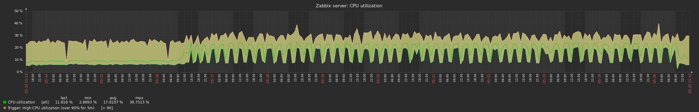

            2. Before the MySQL upgrade, CPU usage was pretty consistent at about 10%. Now (even after the above tuning) when the housekeeper does it's job CPU utilization goes up to about 25%. Is that expected or is there another parameter that needs tweaking?
Name:	2022-05 Zabbix CPU Utilization.png
              I'm glad the changes have made a big difference. I suspected they might, but one never knows. :-)
              The answer to the "should I do more tuning" is always dependent on a lot of factors. Are you satisfied with the current performance? Do you have other high-priority projects that have been delayed while you're working on this? Is it worth your time to spend more time on tuning?
