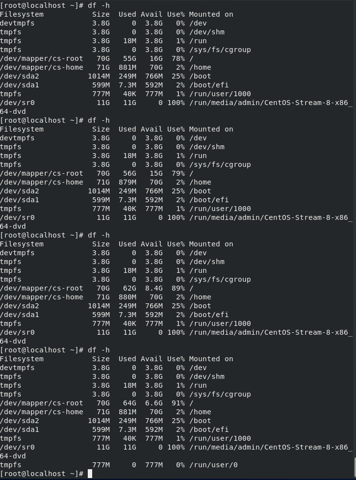

    Hi Everyone,
    I have just downloaded the Zabbix monitoring tool on centOS8(VM host) via Zabbix packages with MySQL and Apache server. Everything is running very smoothly except:
    1. The disk space is filling up very quickly. The screenshot below covers a few hours of information, and it has already filled up the root directory from 78% to 91%. At this fillup rate, no amount of disk space is sufficient.
    2. Is the MySQL database filling up this space with all the information it's gathering, or is it something else? I allocated 150GB of disk space and thought it would be enough for this single application.
    3. How much disk space does it needs, and is there a way to free up space by deleting unnecessary data.
Name:	Screen Shot 2022-05-25 at 3.55.49 PM.png
    • 5004
    150G divided into 2 parts... / and /home... You have one partition.. 70G mounted to / All your data is under that one mountpoint, not just your DB, but everything else aswell, like logs, your whole "linux", etc.. , It will fill up... Even without the help of zabbix..
    But if its just an empty box, not (yet) monitoring many hosts, then your DB should not grow too much (I have one dev box, with quite lot of hosts, but very little data polled, which has 27G DB...) ... You should dig a bit more into that / partition and see, what exactly grows there...
