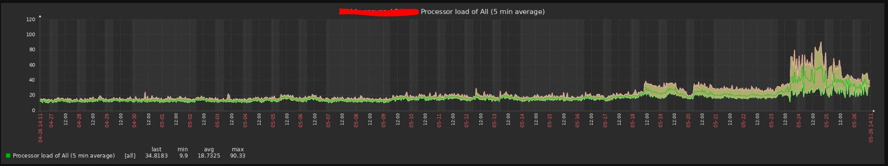

    Few days ago I noticed on my Zabbix server a high cpu utilization so i started to verify this situation. I started to monitorg my cpu load utilization and processes on server which are generating this load and I noticed the preprocessing worker's and preprocessing manager are responsible for this situation.
    At the beginning i added a 8 cores of CPU to server - there was 8, now I have 16 and it won't help. Next I started to manipulate a values in zabbix_server.config - I set the "StartPollers" value to 500 (before there was a 300 value) but my server would not start.
    Above i posted my actual zbx-server configuration and now it's working but still I'm noticing the problem with high cpu utilization. Below I'm adding some screen shots from my Zbx server.
    Cpu load - last 30 days
Name:	cpu load from last 30 days.png

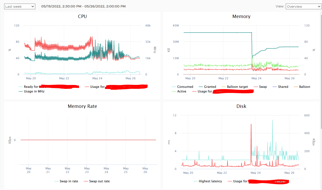

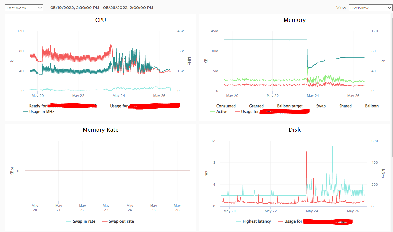

    vSphere - last week metrics of my Zabbix server:
Name:	vsphere look on metrics.png

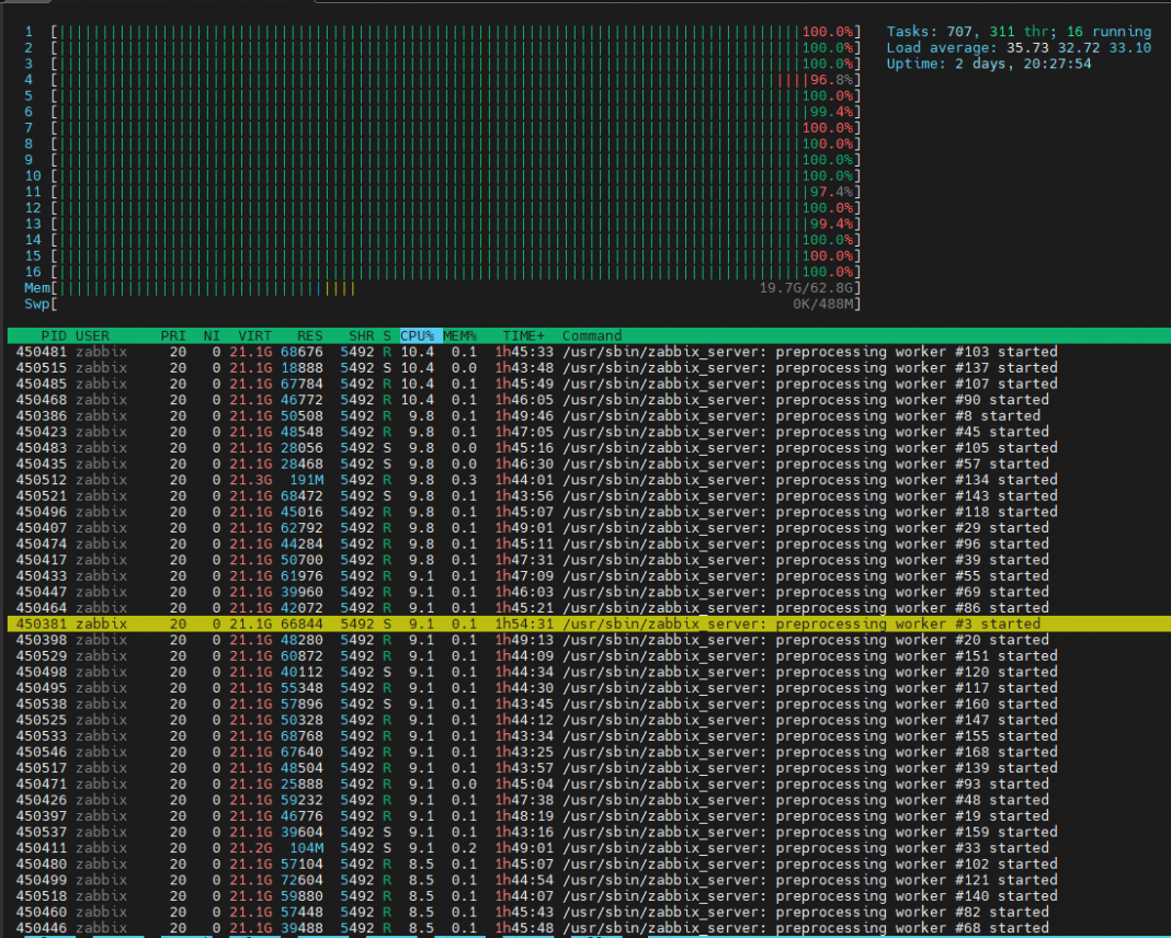

    Htop result:
Name:	load on zbx server and preprocessing workers.png

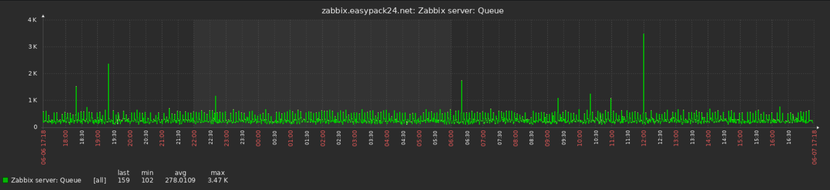

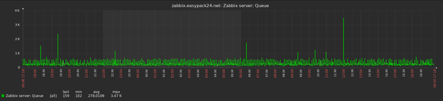

    There is an information: "Optimal number of instances is achieved when the item queue, on average, contains minimum number of parameters (ideally, 0 at any given moment). This value can be monitored by using internal check zabbix[queue]." In my case it looks bad ...
Name:	zabbix queue values.png
Name:	zabbix queue graph 7 day.png
    Could you please help me verify why preprocessing pollers are flapping in this way and help me set the appropriate values for my Zabbix environment ? Is it possible to verify which items are using preprocessing and are "heavy" to preprocess by Zabbix ?

      Here are a few questions/comments for you to consider.
      - What happened on May 18 and May 23 (noticable changes on the processor load)?
      - What does it mean in the VMware Memory graph when "Granted" dropped from ~38G to ~15G on May 23?
      - What happened on May 23 when the VMware Disk latency was increased?
      - If you have identified that preprocessing consumes all your CPU, what prevents you from sharing that load to other servers by using Zabbix proxies?
      - Your 4000 hosts don't surely have their items configured by hand host by host, most probably you have a couple of templates that have the items and their preprosessing rules configured, so check them if you need to know what kind of preprocessing rules you have (or, just check some of your hosts).
      - What do your Zabbix server graphs (for monitoring the Zabbix server processes) tell you about the situation? (Data gathering processes, Data handling processes, Internal processes, Reporting processes, Cache usage, Internal queues, etc.)

        all & all I agree with Markku on the troubleshooting steps.
        for me this indicates you or your colleague probably added some pre-processing of an item / items that is now lagging the the whole zabbix server.
        Imagine if CPU needs to wait for I/O during pre-processing - the pre-process process actually consumes that CPU core which is in wait mode - unable to process anything else until it's done with that process.
        For example running complex string manipulation on large text item can cause I/O wait. There are many ways pre-processing can consume a CPU core and start creating a problem on your server.
        Please have a look at the official DOCs for your installation here: https://www.zabbix.com/documentation.../preprocessing
        Go through your most used templates and re-check if there is not error / wrong logic / too complex task / anything fishy in items pre-processing.
        Disabling an item for limited time in a template may give you a clue which item is causing the problem if nothing else helps... disable the item - observe for 2 or 3 item checks - if situation does not improve - enable & go for next item.

          Markku
          There is a problem with verify it. no history here. I think - someone testing something in Zabbix server - maybe new items with preprocessing.
          Propably it's the result of restarting Zabbix server service, This service didn't work. I should put info about it in main topic - sorry.
          Same as abov - service started so latency grow up.

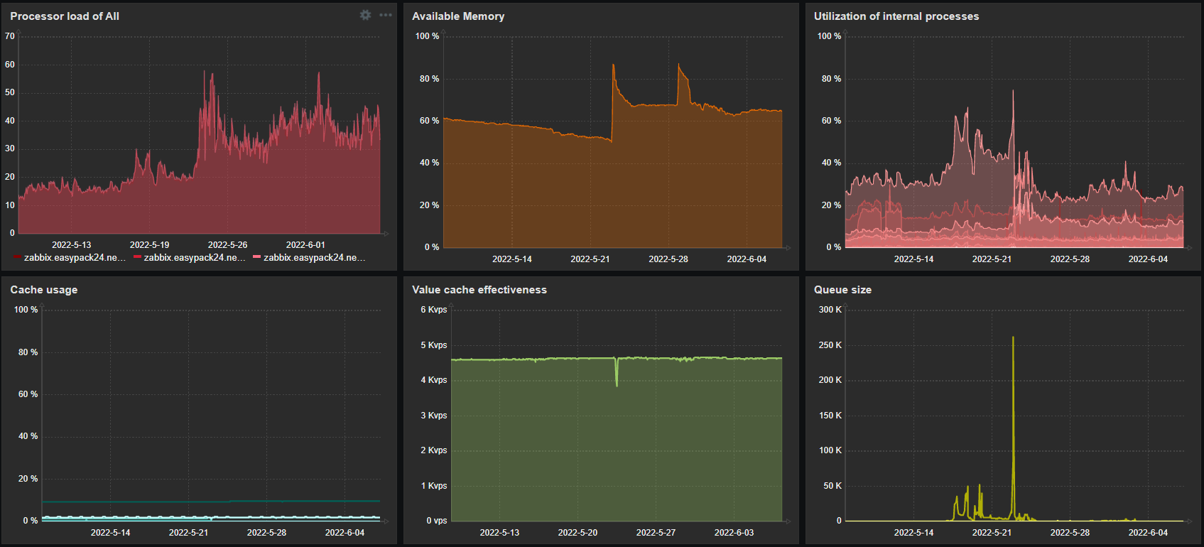

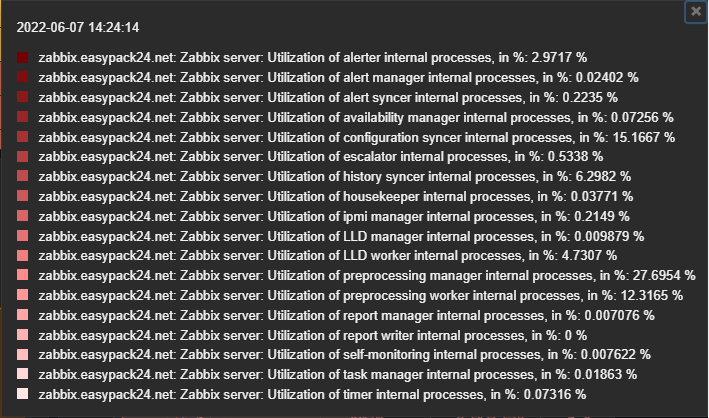

          For now It's little better. Other processes looks well, but preprocessing pollers are flapping from +- 20% to 100% few times per hour.
Name:	answer1 utulizations.png
          Graphs from last 30 days:
Name:	answer1 graphs.png

            How can I calculate: "Total amount of different pollers" for my Zabbix server resources and usage. I read something about Queue size - if this value is possible low - it's good. If this value is high - it's bad for your Zabbix Server. This is my actual Queue size graph from Last day::
Name:	answer2 queue size.png
