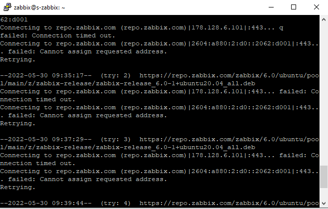

    Same on Ubuntu
    .Click image for larger version
    • katsap
      • May 2022
      Is this related to the blocking of Russian providers?

        • methood
          • May 2022
          Looks like that. Via EU proxy all work well.
