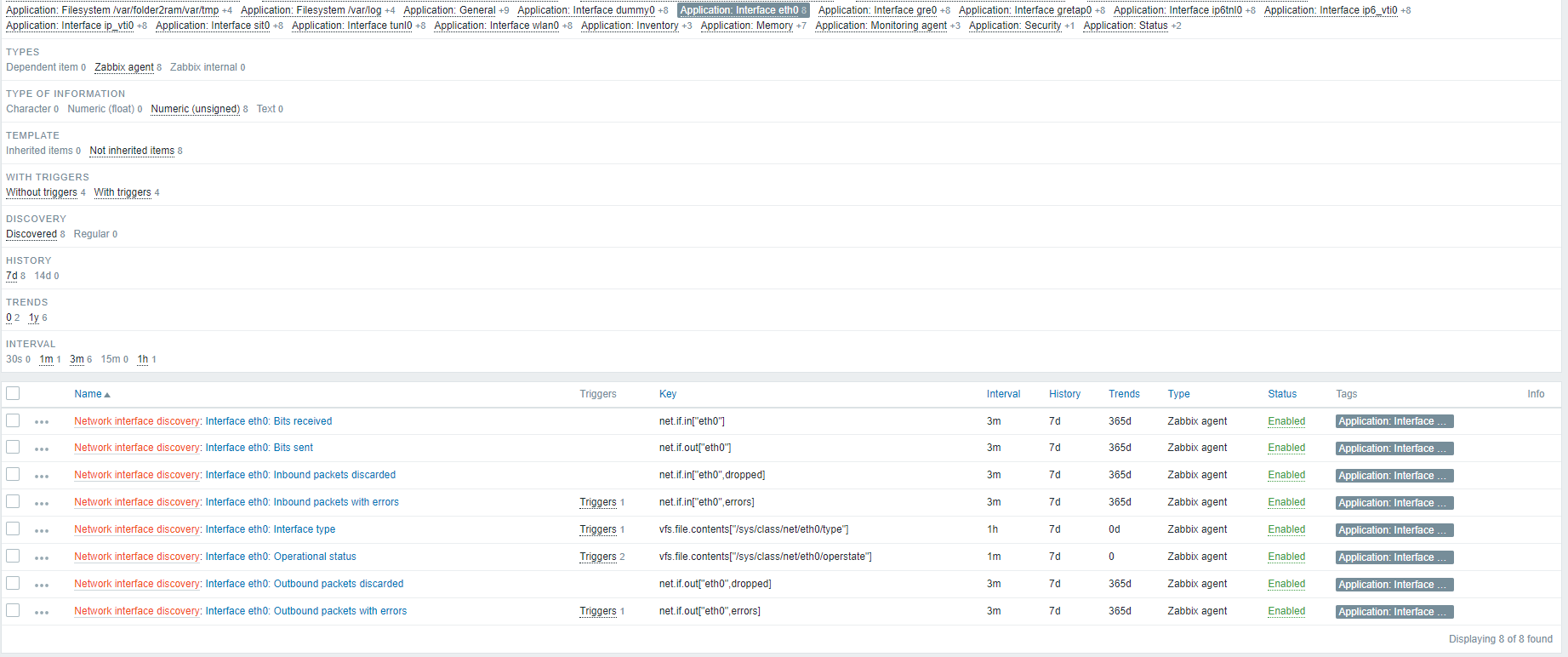

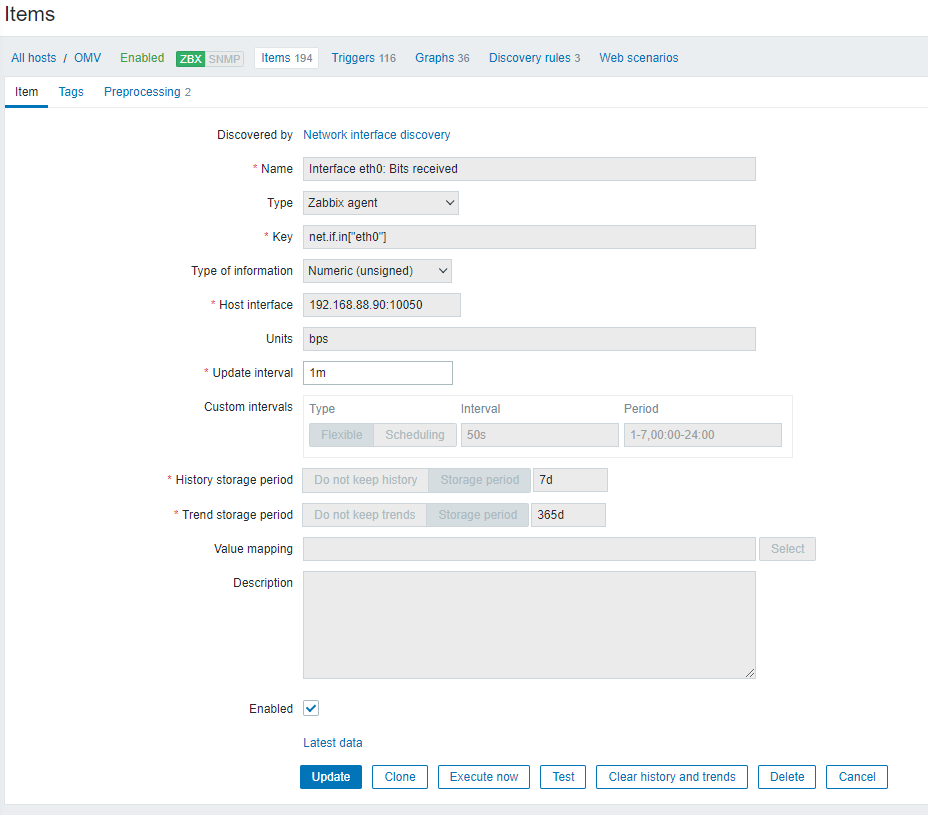

    I can't change some template parameters on the host. For example, by default, all network templates read information in the interval of 1 time in 3 minutes. I wanted to change this setting to 1 minute. I enter data "1m" - update. The data is not saved and reset to "3m". And even with new hosts it is not possible to change templates. Zabbix 6

      That said, I have Zabbix 6.0.5 on my test server and it has the same problem: the host items have the update interval configurable (not disabled, just like in your screenshot), but any changes are not saved. Looks like a bug. You can open an issue at https://support.zabbix.com to get it fixed.
