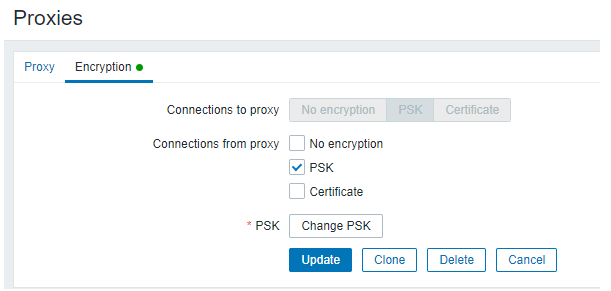

    So I went into the WebUI and tried to create an new Proxy and the option to change Connections to proxy is greyed out.

    I've also checked existing proxies that were configured prior to 6.0.4 and they were configured with Connections to proxy PSK enabled, but I am unable to change that now as the option is greyed out for them as well.

    See the proxy type: if the proxy mode is Active (the default in GUI), then Zabbix server never connects to the proxy, thus the Connections to proxy option is disabled.

      Thanks for the reply, they are in fact active proxies. It's just interesting that this just started not working for us. Thanks again.
