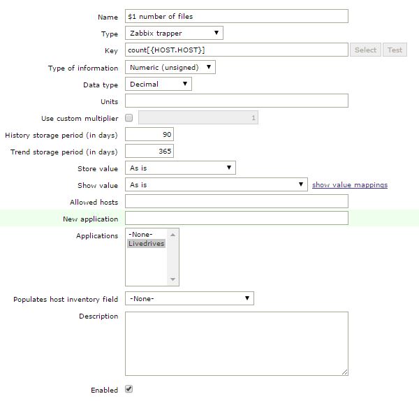

An item inside the template looks like this:

But it don't tells me what's wrong. I maximized the log-level (loglevel 4) and got no hint. I even traced the network traffic to no avail. Now I'm stumped. Can someone hint me where to look for the problem? I already double- and triplechecked all item and hostnames. I debugged the script and can't find a problem there. The only thing I found is, when I create the item directly on the host, without the template, it works. (item key was 'orders.count') but as far as I understood, the usage of an makro inside the item key should net be a problem.
