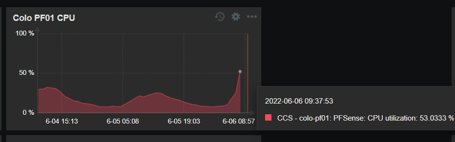

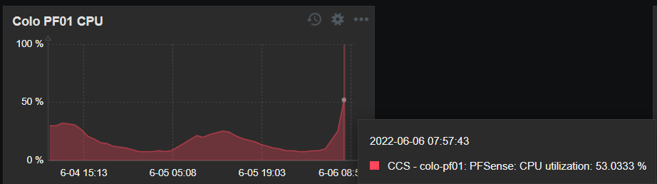

    I set up some dashboard graphs to monitor CPU usage and WAN usage that is retrieved from firewalls via SNMP. The latest data and graphs of the host themselves show current data but from the dashboard they seem to always leave out the last hour.
    I'm not sure what's missing or if this is maybe a bug? This is on Zabbix 6.0.0.

    I just figured this out, these graphs were set to "trend" which won't update as frequently so this appears to be expected behavior. I've updated the graphs to "history" instead for the places where we want to see closer to real-time data.
