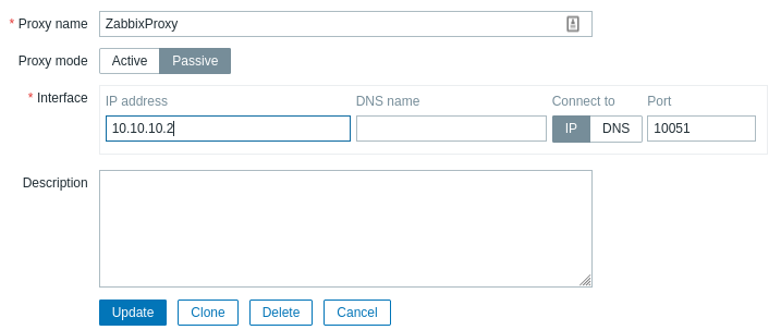

    In the web interface of the zabbix server, I configured the zabbix proxy (passive mode) with Host name ZabbixProxy and IP 10.10.10.2.
    The web page indicates it's reported to be seen every 5 seconds or so.

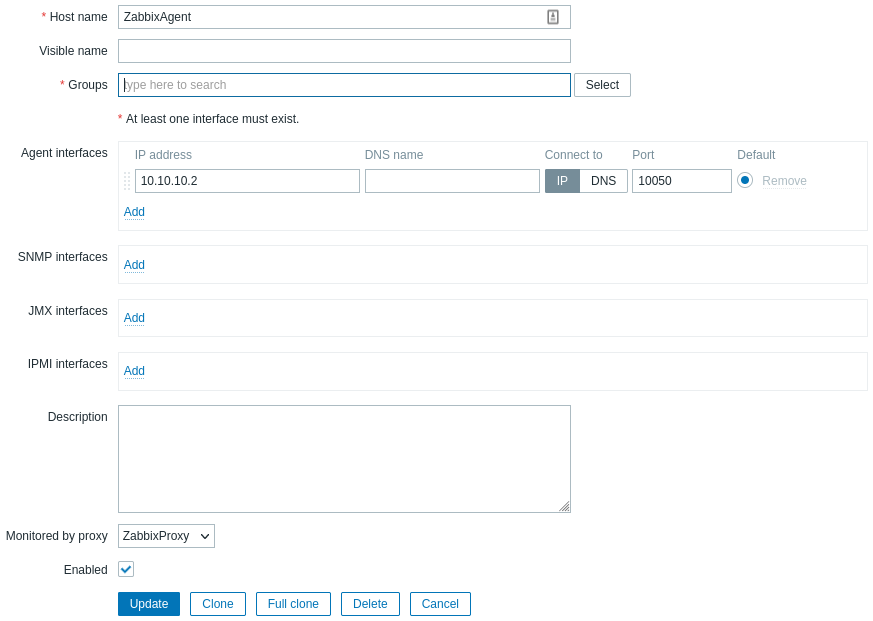

    I added the same machine ZabbixAgent-10.10.10.2 as a host, monitored by the ZabbixProxy.
    Note that the setup is currently completely in passive mode (both the agent and the proxy).
    My problem is: the ZabbixAgent data is not collected, the host is not monitored.

              The agent is monitored by proxy, as mentioned:
Name:	Screenshot from 2022-06-09 14-10-02.png
Name:	Screenshot from 2022-06-09 14-10-43.png
