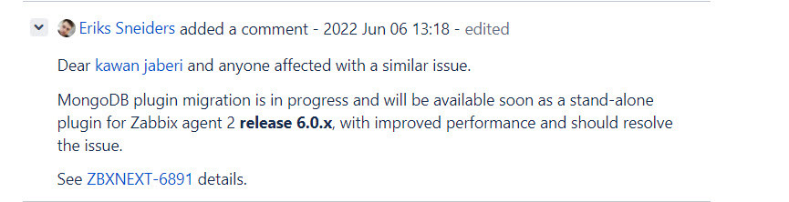

      because of some bug for mongodb plugin on agent we need too add new plugin in zabbix repository
      example support mongo vesrion 5 or get i/o time out error
      also below link: https://support.zabbix.com/browse/ZBX-20404 your colleagues comment and close.

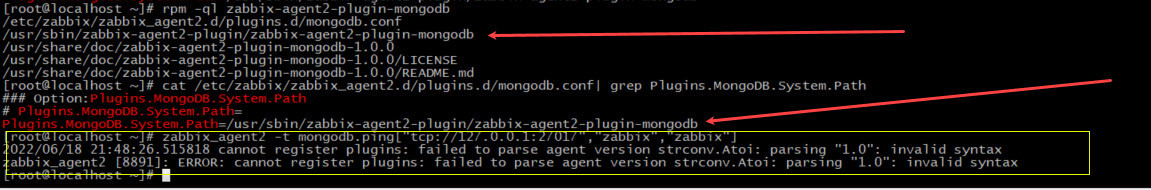

            I now but when add "Path to Plugin executable" to mongo plugin executable too I have error as below pictures.
            So would you please how to find exact path?
            I use below command to find files belong to mongo plugin
            [root@localhost ~]# rpm -ql zabbix-agent2-plugin-mongodb
            /etc/zabbix/zabbix_agent2.d/plugins.d/mongodb.conf
            /usr/sbin/zabbix-agent2-plugin/zabbix-agent2-plugin-mongodb
            /usr/share/doc/zabbix-agent2-plugin-mongodb-1.0.0
            /usr/share/doc/zabbix-agent2-plugin-mongodb-1.0.0/LICENSE
            /usr/share/doc/zabbix-agent2-plugin-mongodb-1.0.0/README.md
            [root@localhost ~]# ll /usr/sbin/zabbix-agent2-plugin/
            total 10776
            -rwxr-xr-x. 1 root root 11034248 Jun 8 07:16 zabbix-agent2-plugin-mongodb
            so this file is executable but when insert in that variable I have below error.
            [root@localhost ~]# zabbix_agent2 -t mongodb.ping["tcp://127.0.0.1:27017","zabbix","zabbix"]
            2022/06/18 21:48:26.515818 cannot register plugins: failed to parse agent version strconv.Atoi: parsing "1.0": invalid syntax
            zabbix_agent2 [8891]: ERROR: cannot register plugins: failed to parse agent version strconv.Atoi: parsing "1.0": invalid syntax
