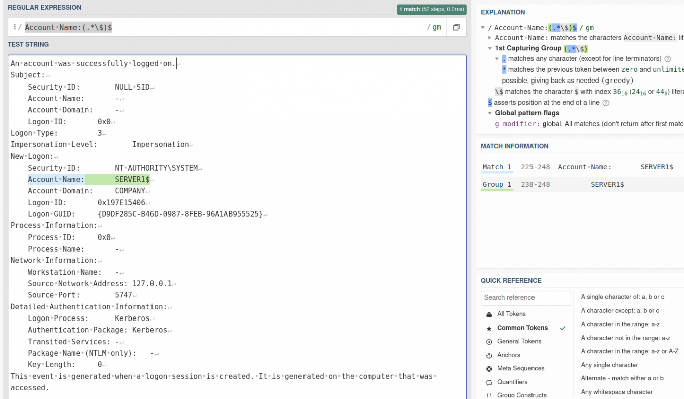

    Here is my regex:
    Account Name:(.*\$)$
    At regex101, this works and locates the second Account Name, if its ends in a dollar sign ($), it will match. However, using this exact same event log and regex in preprocessing, I get string doesn't match.
    I must be doing something wrong. Can anyone make a suggestion?
    Thank you.
    • 5008
    It works, if you remove $ from the end... tested on 4.4 and 6.0

      Unfortunately, it doesn't. In the example 4624 I posted, the first occurrence of Account Name: is -. But sometimes, it may have something else like SERVERNAME$. The goal was to have the regex only pick up the second occurrence of Account Name because that will always be what is needed. The trailing $ s supposed to say match second occurrence.
      I am guessing this doesn't work in preprocessing?

        Have you tried with (?m) modifier? https://www.pcre.org/original/doc/ht...tax.html#SEC16, the multiline option
        (?m)Account Name: (.*\$)$

          I think I will have to work around this another way. It seems that even doing that, it will match whichever has a $ at the end. So if the first one does and the second one doesn't, it will still match. I appreciate everyone's help on this.
            • 5008
            You never said you want to have "always a second match".. you said, regex found the second Account Name, the one with $ in the end.. That's not exactly same..
            And "trailing $ s supposed to say match second occurrence" ? Where that comes from? $ is end of string, not "last match"..
            Regex preprocessing goes until finding a match, it will not return second one (or third, or n-th...) like regex101 does...
            in regex101 "New Logon:\s+Security ID: (.*)\s+Account Name.*\$)$" also works and returns just one match, the second "Account Name", but not in zabbix...
            Maybe you can try with JS preprocessing...
