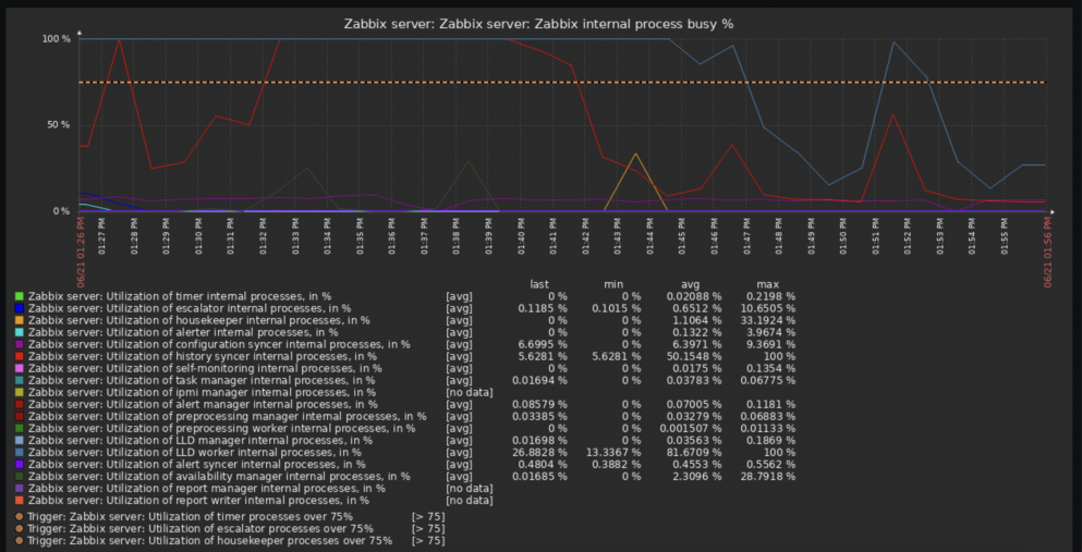

    1) The lld worker internal process get up to 100%

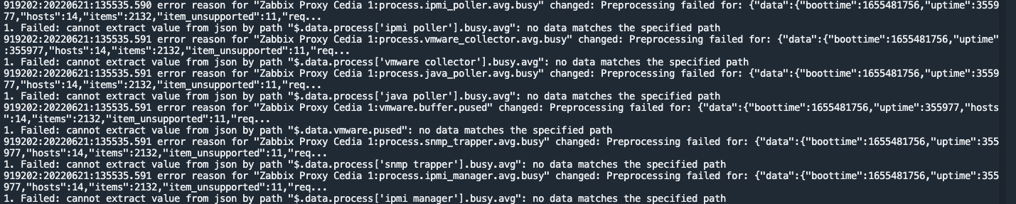

    2) On the zabbix server logs I see this kind of logs. Correct me if i'm wrong, this has to do with low history syncer value??
