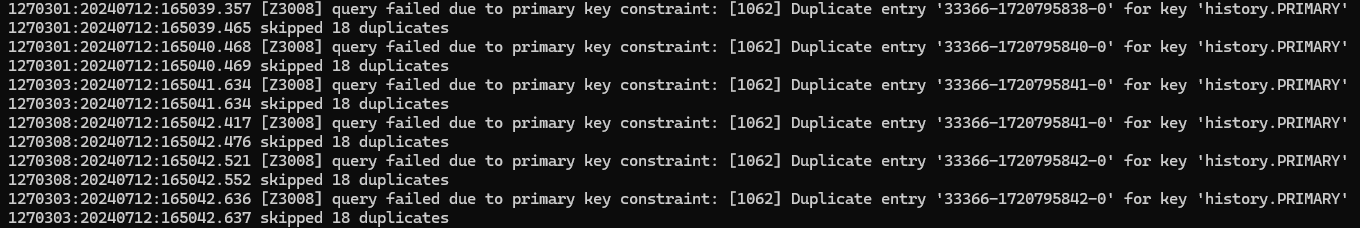

      With your permission, I am resurrecting this old topic.
      I have a similar issue. My own tool feeds the Zabbix trapper, and I see duplicates in the log. Based on this topic, I modified the tool to send data more precisely with nanoseconds, but duplicates still occur. The probability that the records are really hitting the same timestamp is a few bambillions to one.
      The values I marked on the screenshot should be nanoseconds which should be correct for the database, right? So it seems that Zabbix/trapper does not recognize the nanosecond timestamp(?)
      What could be the potential problem, and what solutions could I try?

        I'm now testing with Zabbix server+proxy+sender 7.0.0, and it seems to save the nanoseconds correctly:
        $ zabbix_sender -z 192.168.7.82 -s Zabbix70-agent -k actiontest -o 0
        Response from "192.168.7.82:10051": "processed: 1; failed: 0; total: 1; seconds spent: 0.000065"
        sent: 1; skipped: 0; total: 1
        MariaDB [zabbix]> select itemid from items where hostid = 10582 and key_ = "actiontest";
        | itemid |
        |  46004 |
        ​MariaDB [zabbix]> select * from history_uint where itemid=46004 order by clock desc limit 1;
        | itemid | clock      | value | ns        |
        |  46004 | 1720798871 |     0 | 761968449 |
        Are you sure that your own tool uses the correct format to send the nanoseconds? That's the obvious first question.
