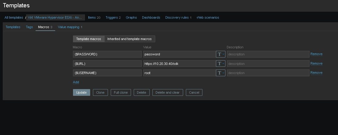

    I am using Virt VMware Hypervisor ESXi - Andre Bello after import template in the zabbix I did follow steps:
    1- added 3 macro
    {$USERNAME} ----> root
    {$PASSWORD} -----> password
    {$URL} -----> https://esxi1.com/sdk
    Also ad host with UUID

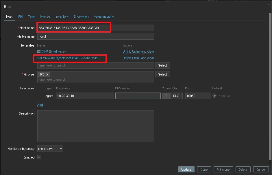

        (Alternatively, if you rename the ESXi host in Zabbix to use the UUID of the ESXi host, that should work as well.)
        • bab
          • Aug 2020
          • 194

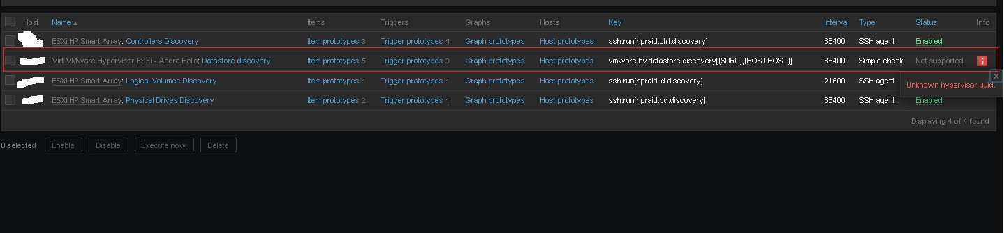

          According to attached pic I did above solution but another it shows that error (I attached all info)
          • Markku
            • Sep 2018
            • 1784
            The discovery interval is one day. Did you Unlink and clear the template from the host and then add it again? (= is the error new or old)

                    Is that your mean my uuid is not correct ?I used this command to get uuid ;
                    vim-cmd hostsvc/hosthardware | grep uuid
                    uuid = "38393638-3435-4e43-3738-333930335939",
                    That's lower case, yes, but in your screenshot you have it in upper case.

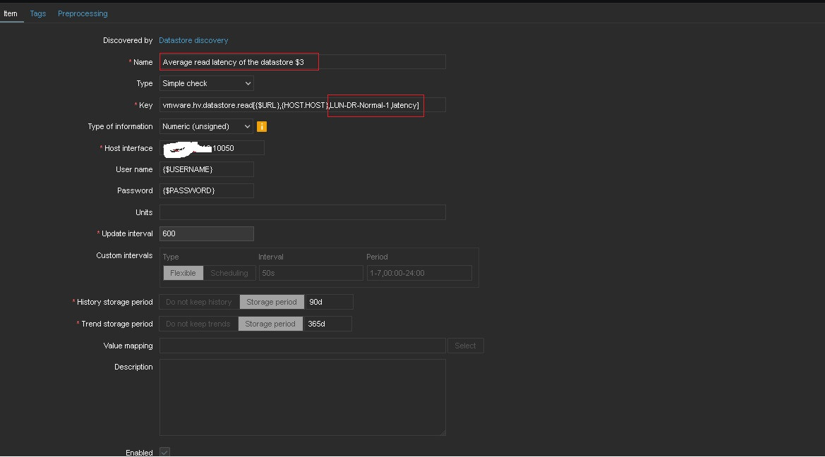

                      Thanks . It solved with lower case . Just one question
                      in latest data it cannot show datastore name and show "Average write latency of the datastore $3" actually for all of datastorename use $3 . when I click on it ,shows correct datastore name in the key but it returns parameters in the Name field (please see attach pic)
                      • Markku
                        • Sep 2018
                        • 1784
                        You need to manually replace $3 with LUN-DR-Normal-1.

                          I have many datastore and there are many items about datastore on this template such as datastore latency , datastore total space , datastore free space , ...
                          It shows all parameters for datastore$3 for example it show about 15 Datastore Free $3 , it shows about 15 Average write latency of the datastore $3 . How can define datastore name instead of $3 ?
                          • Markku
                            • Sep 2018
                            • 1784
                            See the item prototype and reconfigure it there.
                            Markku
                            • bab
                              • Aug 2020
                              • 194
                              Markku
                              This is my item prototype name : Average write latency of the datastore $3
                              This is key : vmware.hv.datastore.write[{$URL},{HOST.HOST},{#DATASTORE},latency]
                              Do I have to use $DATASTORE instead of $3 ?
                              • Hamardaban
                                Hamardaban commented
                                {#DATASTORE} , not {$DATASTORE}
