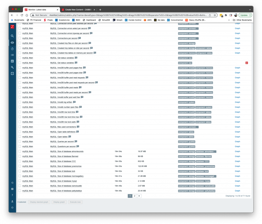

    I am running Zabbix on a RPI, monitoring a Ubuntu 20.04 Server. I have verified that I can talk to the client Ubuntu Server from the Zabbix Server. I have upgraded to Zabbix 6.2.
    When I look at the latest data, I can only see a few items such as the size of my databases and the fact that it is up. All the other parameters are missing. A sample of the latest data attached.
    I have checked my config several times and not sure what to do next. Click image for larger version
Name:	Screen Shot 2022-07-09 at 2.12.16 PM.png
    ​​​​​​Newby with this app. Any suggestions?

      Why do you have two "MySQL: Get status variables" items, what's the source of them? That is the master item for parsing the data for almost all other items.
      See what does the red exclamation mark tell you about the error.
      Did you install the MySQL template according to its instructions, with the correct configuration file+settings for the Zabbix agent?

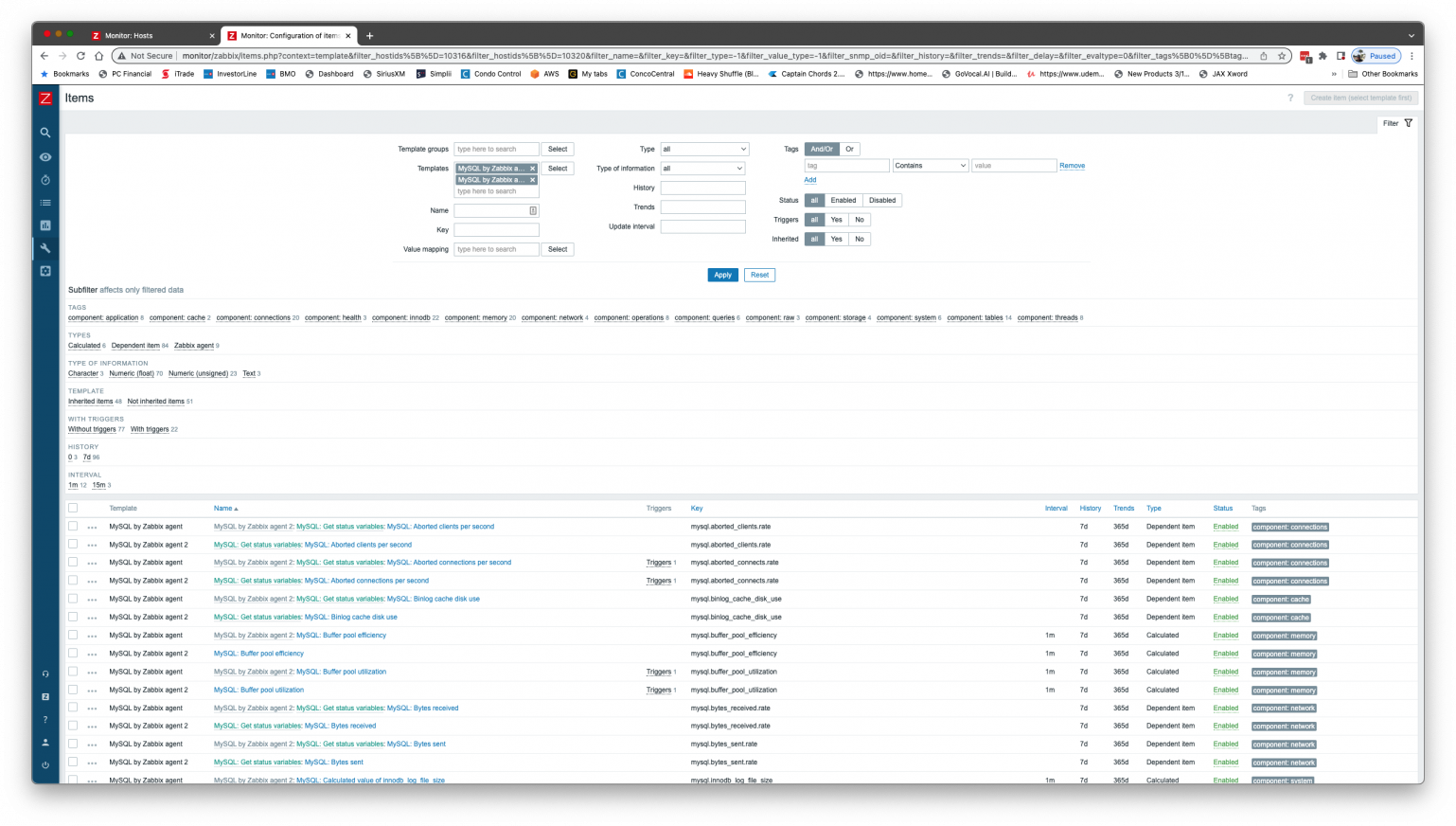

                          Ok there is a misunderstanding here. I'd like you to show the item configuration, in Zabbix GUI. You were showing the UserParameter configuration in the agent configuration.
                          So go to the "mySQL Main" host configuration, Items, open the "MySQL: Get status variables" item, and take a screenshot there.
                          This is because we need to find out how that UserParameter is called by Zabbix.
                          In your first screenshot (the Latest values list) there are two of those items, please provide them both so that we see where they are coming from, there should be the template name in the top as well.

                            Sorry. This is new to me. Is this the screen shot you are looking for?

                            • Markku
                              • Sep 2018
                              • 1784
                              I see you have all the items in double: first provided by the "MySQL by Zabbix agent 2" template and then locally, maybe you have unlinked the template at some point without deleting the items?
                              Anyway, please scroll to the "MySQL: Get status variables" item and click it to open it, and show that to us.

                              • Markku
                                • Sep 2018
                                • 1784
                                #15
                                Actually, I was able to locate that template in git.zabbix.com and see the item there.
                                Apparently the item key is:
                                mysql.get_status_variables["{$MYSQL.DSN}","{$MYSQL.USER}","{$MYSQL.PASSWO RD}"]
                                So, one of those three macros have incorrect character(s). Check and fix those macros in the host "mySQL Main".
