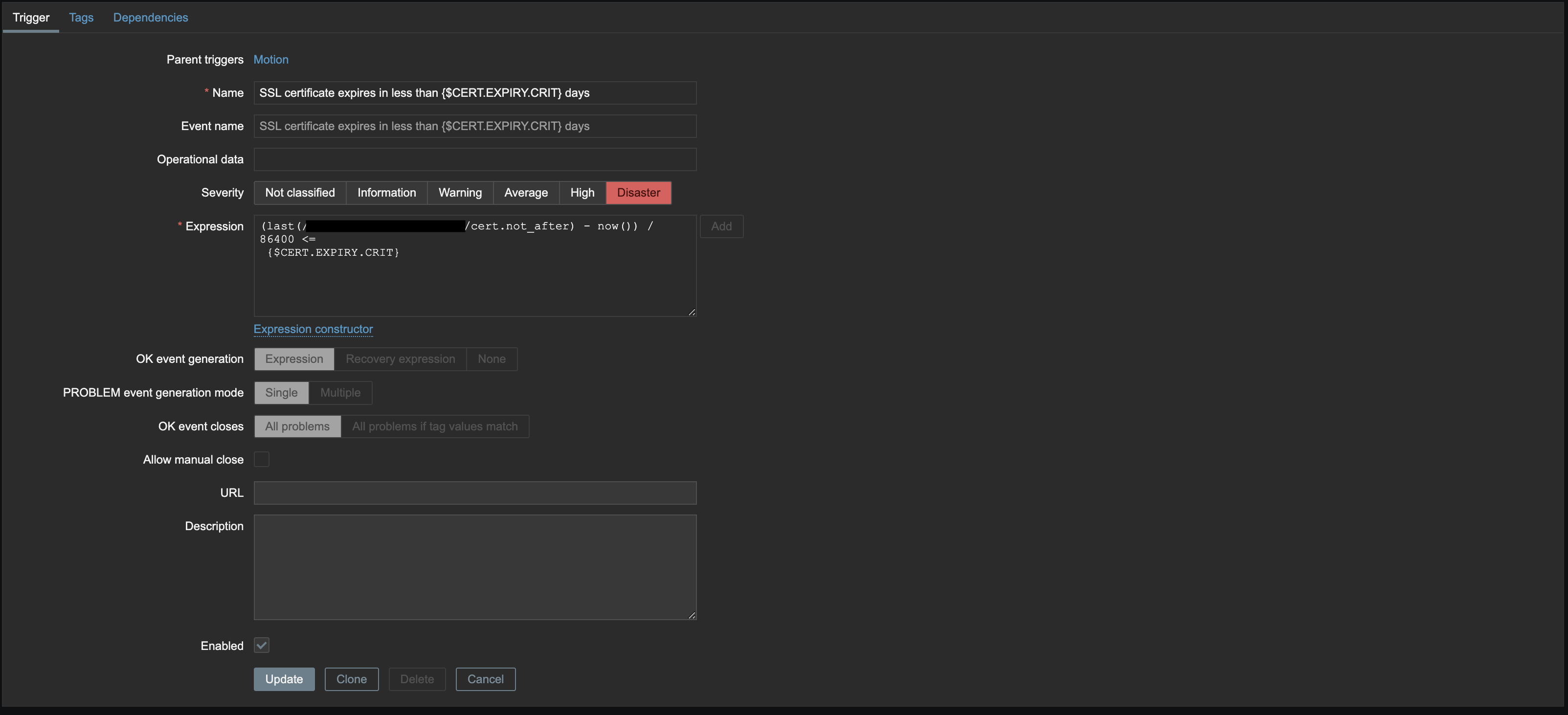

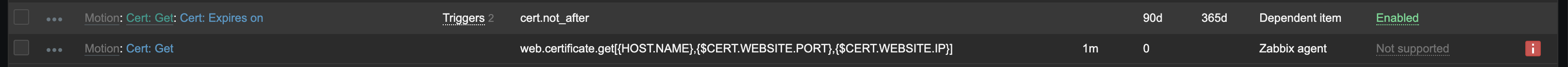

    I am using web.certificate.get to monitor SSL certificates to see their expiration. I have configured the trigger as attached. It works except for when the Item return timeout (if someone forgot to add a firewall rule) "ZBX_NOTSUPPORTED: Cannot fetch data: dial tcp <IP ADDRESS>:443: i/o timeout.".
    How can I expand this trigger, or create a new trigger that sends an alert if this happens?
