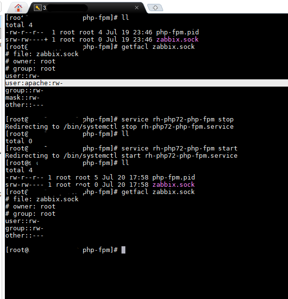

        Digging a little deeper I found out that the user 'apache' is removed from the permissions after the service restart. Do you know what might be causing that?

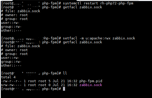

            I tried that last code block and it didn't add a new user. I was trying to add apache, but also tried zabbix and neither was added.

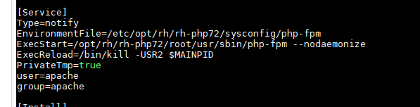

                      1. I edited /usr/lib/systemd/system/rh-php72-php-fpm.service to add user=apache and group=apache.

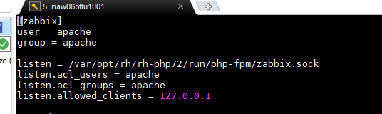

                      2. I edited /etc/opt/rh/rh-php72/php-fpm.d/www.conf to use apache for user and groups.
                      3. I edited /etc/opt/rh/rh-php72/php-fpm.d/zabbix.conf to include apache for user and groups.
                      After running "systemctl daemon-reload" and restarting the services "systemctl restart zabbix-server zabbix-agent httpd rh-php72-php-fpm" I still get the same issue with apache being removed from the permissions of var/opt/rh/rh-php72/run/php-fpm/zabbix.sock.

                        1. Remove the 'user=apache' and 'group=apache' from the rh-php72-php-fpm.service systemd service file. That may cause other problems, and it's not fixing the issue here. Note that if you need to modify a systemd service file in the future, don't edit the file directly, instead use 'systemctl edit whatever.service'. That automatically creates an override file for you, so your customizations are preserved even if the /usr/lib/systemd/system/whatever.service is updated.
                        2. In /etc/opt/rh/rh-php72/php-fpm.d/zabbix.conf, make the following changes:
                          1. Your settings for user and group are good, leave them as they are
                          2. comment out your settings for 'listen.acl_users', 'listen.acl_groups', and especially 'listen.allowed_clients'. The 'listen.allowed_clients' is only supposed to be used when you're using a network port. It's not needed if you're using a unix socket. Having it set shouldn't be doing any harm, but as I said above, the UNIX socket method wasn't well-tested in earlier versions of PHP-FPM, so it's better to just leave it commented out.
                          3. add the settings (if your file has comments and a list of available statements, these two lines would be just above the 'listen.acl_users' and 'listen.acl_group' that you commented out in step 2):
                        listen.owner = apache
                        listen.group = apache
                        You don't need to uncomment or set 'listen.mode', the default of 0660 should be what you want.
                        Now try your reboot and your service restart, and see if you reliably get the socket permissions you want.
