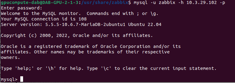

    However, on the machine on which PHP is running, I can run the following:
    And that works fine, so it's for sure not the DB server, which is running with Zabbix Server just fine, by all appearances.
    I've also tried manually setting the port (3306). Permissions were granted to the user at '%', so it shouldn't be a permissions thing there.
    Any ideas?
    Thanks!
