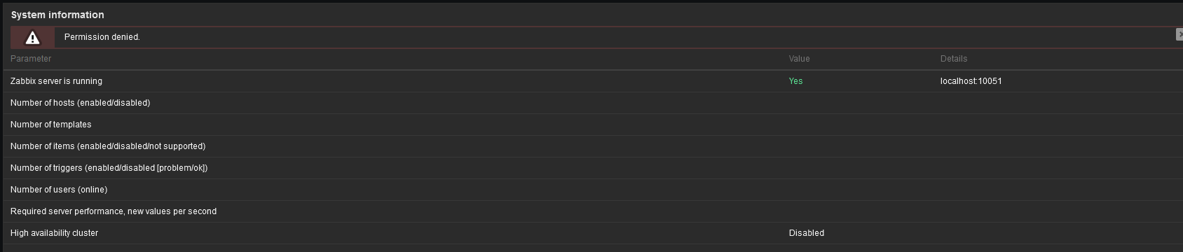

    Hello guys,
    after upgrading to Zabbix v6 the widget "System Information" shows "permission denied".
    The error disappears from time to time.
    Is there a solution?
    BR
    Chris.

    Can you see something interesting in the Zabbix log file?

      zabbix_server.log is fine.
        • 4996
        If you enable debug mode, you may be able to see, what kind of queries fail...

          User of which role is this that views the dashboard? Also, does logout-login solve the problem? If not, do you have another tab open with the same user (messed up sessions)?
          • christianmolecki
            • Nov 2017
            • 24
            My user has Super admin role.
            Debug Mode
