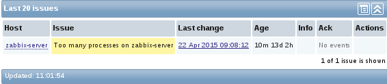

    Fake issue in "Last 20 issues" table.
    There was a problem several month ago and after some hours the problem was solved it and everything was fine. During the one of housekeeing processes the original event has been removed from the DB but I think a non graceful shutdown in MySQL/Server caused the related alarm appears on "Last 20 issues" table on the dashboard.
    The question is how can I remove this fake alarm on dashboard? (delete record from DB by hand or run a command on DB, etc.)

      What is the latest data for that item? Is that value over the trigger level? Is it updating? Are other items for that host updating?
      You could unlink & clear the template, update the host, then relink the template.

        If its a bug, you can fix this by going into the database and change the "value" field in the triggers table.
        I just had to do this today for a bunch of triggers that didn't have hosts associated to them and they appeared in the dashboard.
