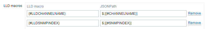

    I defined two LLD macros in my discovery rule:
    but,
    I'm now getting an error on Zabbix that it's not valid JSONPath.
    My idea is that it's having problems with the curled brackets in the object name but I've been googling for hours and can't find a way to get around this.
    Any ideas?

    Seems like I should've posted in this forum earlier because I found the solution minutes after posting this,
    all I had to do was add closed brackets to the JSONPath:
    Maybe this'll be usefull to someone in the future.
      • 4996
      You need this LLD macros part, if you are assigning values from "ordinary" json to specific macros, like... "{#ID} → $.id".
      but you already have macros in that json, so you don't need to preprocess it and point to somekind of jsonpath element... It is already "preprocessed" to be used ... Think of different FS templates... specific agent items also return similar preprocessed json with all macros present, so you only have to use them, no need to additional macro assignment...
