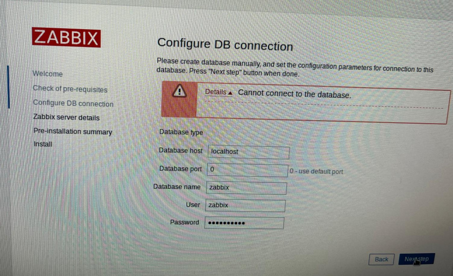

    All the prerequisites are "OK". But when I go to "Configure DB connection" page, I got an "cannot connect to the database" error.

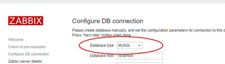

    And the "Database type" row is empty (normally there would be a scroll down list with options , like the first picture I attach.)
    Please refer to the 2nd picture I attached for the error.

    I tried to change Database host to 127.0.0.1 or the IP I configured for the VM; I tried change database port from 0 (which means default port) to 3306 (which is Mysql server default port); Tried use root user to connect instead of zabbix user.

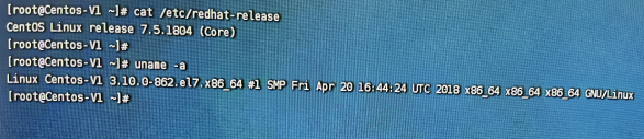

        1. My CentOS version:

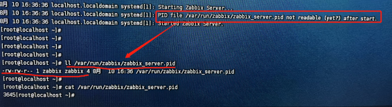

        2. When I check zabbix-server status

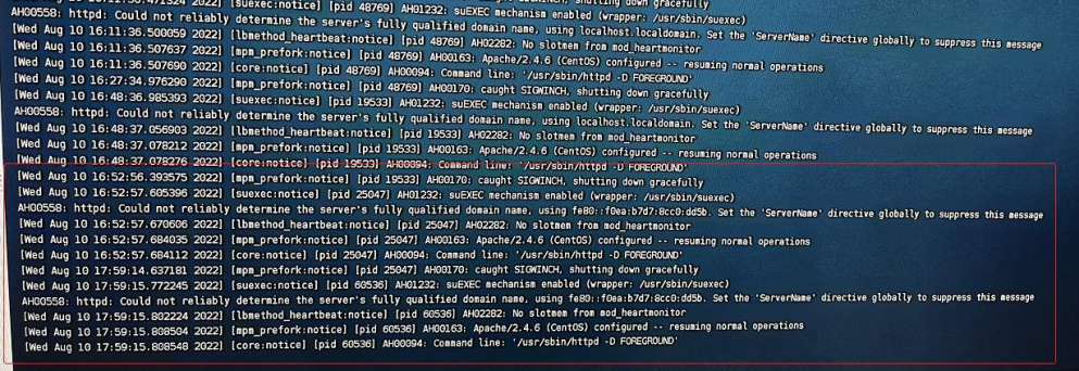

        3. httpd error_log
