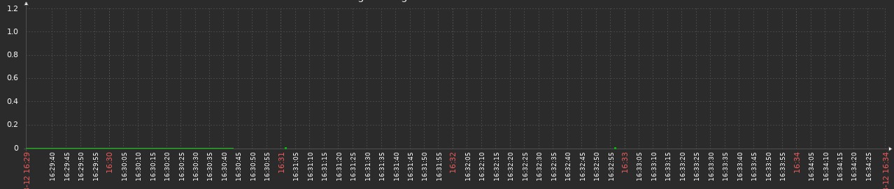

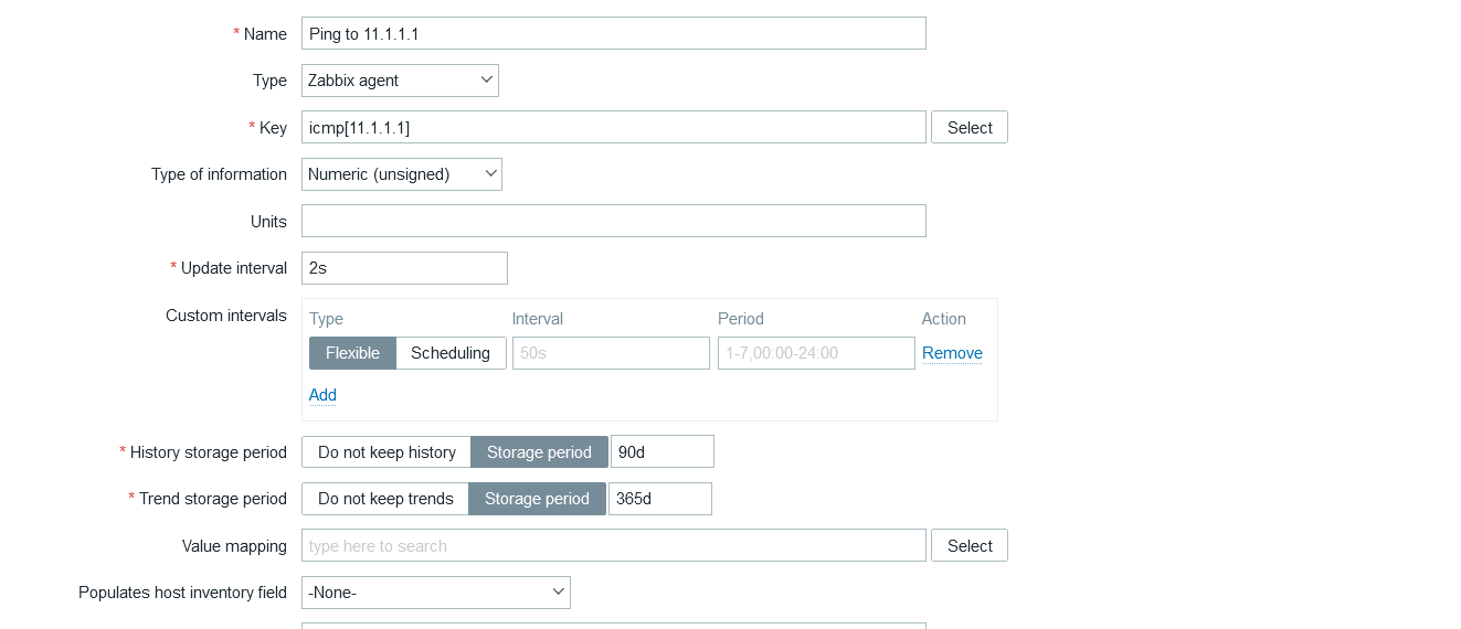

    Good afternoon, I can’t understand where to dig, I put a check
    zabbbix_agentd2 - UserParameter=icmp[*],fping -t 300 $1 | grep alive | wc -l Timeout=30
    but it doesn't update every 2 seconds

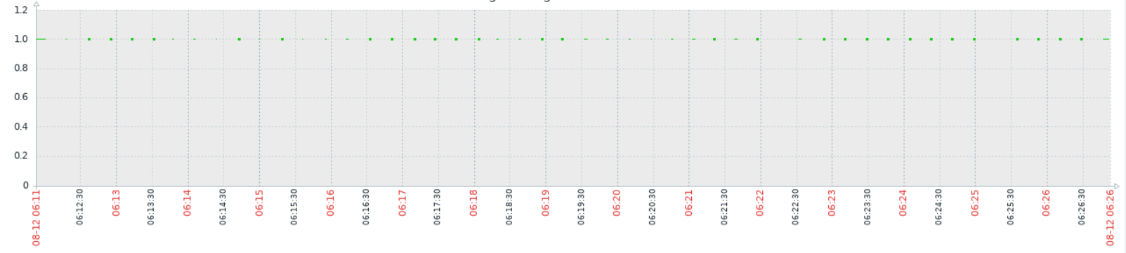

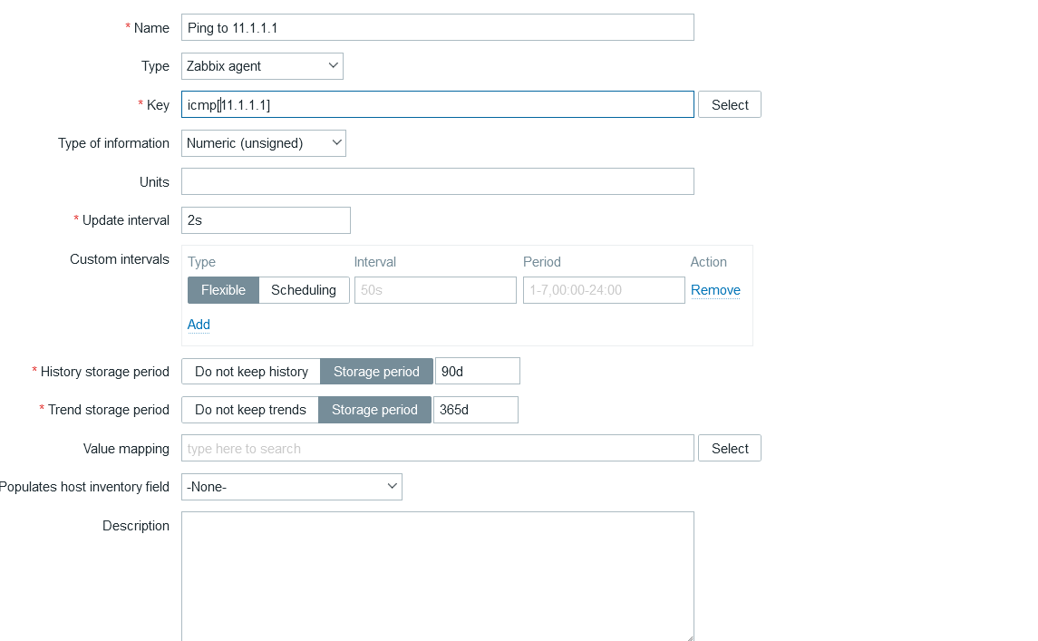

    I have this on version 5.4 and on the new version 6.2
    server where 6.2 is new (absolutely empty) on other hardware in a container
    and 5.4 and 6.2 in containers
    If you do it with your hands through zabbix_get and do a cycle every second, then everything works fine
    please tell me why and what to do to solve it?
