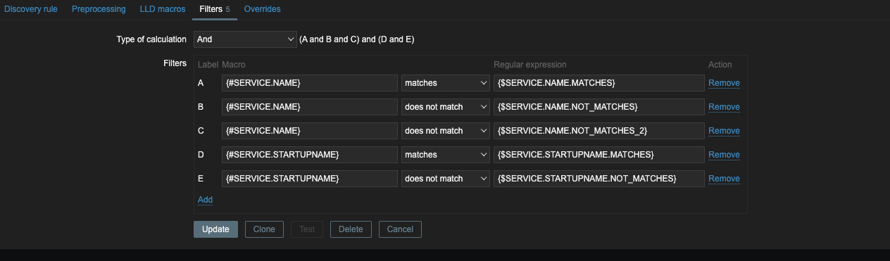

    That number 2, regex in Admin/General... that shoudl not be touched, your templtes do not use it.
    I think your logic in that filter is wrong, if you want to use 2 separate exclude macros... (A and B and C) ... it will never become true, if you think a little here.
    I think it should be (A and (B or C)) .

      Thanks for the response cyber. I have joined them all under the same macro now to make it easier but I'm still getting alerted.

          For managing my exclusions, I use the 'Windows Services names for discovery' regex under Administration -> General -> Regular Expressions rather than {$SERVICE.NAME.NOT_MATCHES} as I found the former to be more flexible and easier to manage. This is what my 'Windows services discovery' Filters section looks like:
Name:	Screenshot from 2023-03-21 14-03-15.png
          And the regex:
Name:	Screenshot from 2023-03-21 14-04-42.png
          This works well for me and excludes the services I don't wan't discovered. And IMHO, it is easier to read and manage.

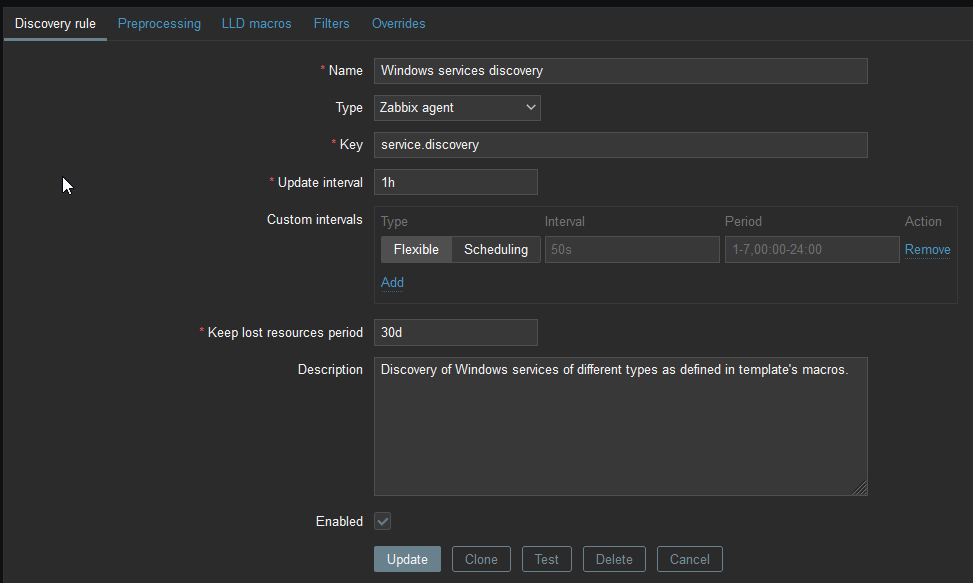

                  By default the discovery keeps lost items for 30 days before they are removed from the monitored host:
                  You can temporarily change the 'Keep lost resources period' value to 0 and manually execute a discovery on the hosts so they immediately drop the excluded services and alerts.
