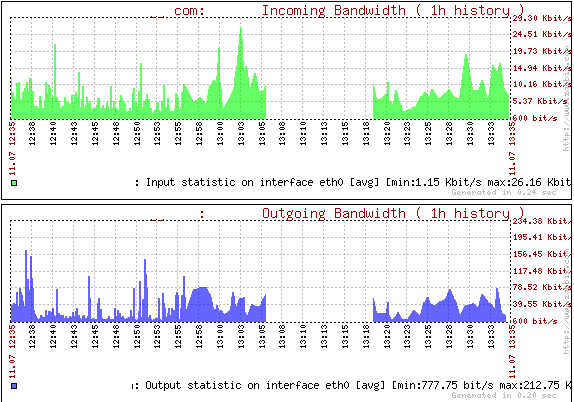

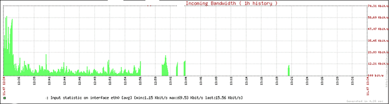

      Ok, I've spent some time watching the logs on all servers, and now that I've got my firewall issue squared away, monitoring seems to be fine between the hosts and Zabbix server.
      Data values are sent TO Zabbix server just fine, I can see them in the output from the hosts log via tail.
      Graphing bandwidth is a clear difference in accuracy however once I switch from monitoring one host, to monitoring two hosts. Is this normal?
      On both of these screenshots below, the portion of the graph on the left is when I was *only* monitoring this host, the portion on the right is when I started monitoring *two* hosts. The closeup shot is hourly detail (where you can barely see any data after I started monitoring 2 hosts), the other is a 'screen' with both incoming and outgoing bandwidth - same comparison of before and after... but you can clearly see more data in this view than looking at an hourly view.
      Maybe it's just me, and this is normal?
