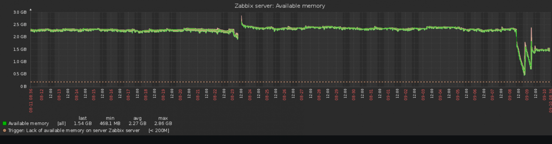

      tim.mooney Environment is in a cloud, and yes, it is an Ubuntu VM running Zabbix server and MySQL/MariaDB. Ubuntu 16.04, 2x cores, 4GB RAM, Premium SSD OS disk (and Zabbix installed there). Zabbix server version - Zabbix 4.4.10
      Firstly I eliminated an option lack of RAM memory, because looking at Zabbix VM RAM metrics, seems like available memory for the server is always more than enough, barely utilizes more than 2GB. . Please ignore the last fluctuations since 8th of Sep, as I set "pool_buffer_size" 128M ---> 2G, then once got more issues, reduced to 1G at 9th of Sep.
      But now I assume these metrics were misleading me, it always had enough memory, but because "pool_buffer_size=128M" default value been set and we never utilized full RAM capabilities, am I right?

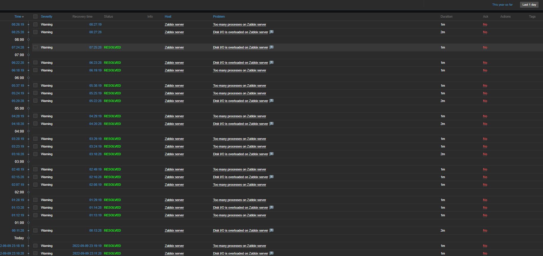

      Below are some latest problems for the last day (buffer_size =1G) and some adjustments to Zabbix config settings done as well:
      CacheSize=24M --- > 64M
      HistoryCacheSize 16M (Def)----> 32M
      HistoryIndexCacheSize=4M (Def) ---> 8M​
      Do you suggest something like 8RAM and "buffer_size" = 4G would solve the issues?

            tim.mooney upgraded server to 2x cores, 8 RAM.
            What values would you suggest for below ones? As currently they are:
            LogFileSize=0
            StartPollers=80
            # HousekeepingFrequency=1
            # MaxHousekeeperDelete=5000
            #StartPollersUnreachable=80
            CacheSize=128M (this I have increased from 24M)
            HistoryCacheSize=64M (this I have increased from 16M default value)
            HistoryIndexCacheSize=16M (this I have increased from 4M default value)
            LogSlowQueries=3000
            Housekeeping values are around before upscale VM and amending some Zabbix config values:
            14443:20220912:065043.110 housekeeper [deleted 376135 hist/trends, 0 items/triggers, 25 events, 5 problems, 1 sessions, 0 alarms, 64 audit, 0 records in 114.670025 sec,
            14443:20220912:075240.331 housekeeper [deleted 375877 hist/trends, 0 items/triggers, 18 events, 7 problems, 1 sessions, 0 alarms, 127 audit, 0 records in 116.709359 sec,
            14443:20220912:085432.038 housekeeper [deleted 375554 hist/trends, 0 items/triggers, 17 events, 1 problems, 1 sessions, 0 alarms, 125 audit, 0 records in 111.176559 sec,
            After increase up to 8GB of RAM:
            16372:20220912:125327.070 housekeeper [deleted 318117 hist/trends, 0 items/triggers, 34 events, 3 problems, 1 sessions, 0 alarms, 104 audit, 0 records in 224.325961 sec,
            16372:20220912:135531.031 housekeeper [deleted 405427 hist/trends, 0 items/triggers, 22 events, 1 problems, 3 sessions, 0 alarms, 129 audit, 0 records in 123.445167 sec,
            Also, I am still getting Zabbix trigger of "Too many processes", trigger value is 300, may it is too low?
              If all of the other warnings have gone away, then I would say most of the I/O issues have been taken care of by the increase in RAM and the tuning settings you changed.
              I don't know what to tell you about the "too many processes" trigger. That's not one we use. My guess is that you should indeed adjust the threshold to account for the number of processes your install needs.
